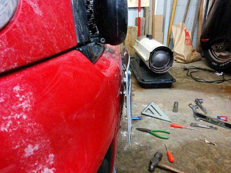

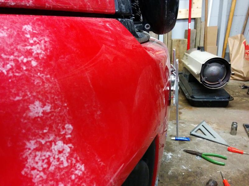

After getting a ticket for $115 for no front plate in NY state I figured I should put the plate on the car. All of the brackets I found online cost between $80 - $100 so I decided to make my own. It only cost $19 and looks as good or better.
The hardest part was finding a bolt with the right threads to fit where the tow hook goes. In fact I couldn’t find it. The cheapest option I could find was to buy an aftermarket tow hook on Amazon and modify it. I found this one for $10 shipping included.
Amazon.com: Docooler Racing Tow Towing Hook for Universal BMW European Car Auto Trailer Ring (Blue): Home Improvement Amazon.com: Docooler Racing Tow Towing Hook for Universal BMW European Car Auto Trailer Ring (Blue): Home Improvement
The hook on the end unscrews leaving behind a M22 x 1.75 thread which any hardware store should have a nut for. I cut about half the thread off the end to get the desired length. I bought some 1” aluminum strap from Home Depot and bent it in my vice so that it followed the contours of the bumper. I used a couple thick washer to space it away from the bumper so that it rub. I then attached the two vertical strips for the plate to attach to.
Sorry the car looks like crap but we've been getting snow the last few days here in Buffalo, NY.
