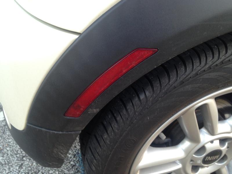

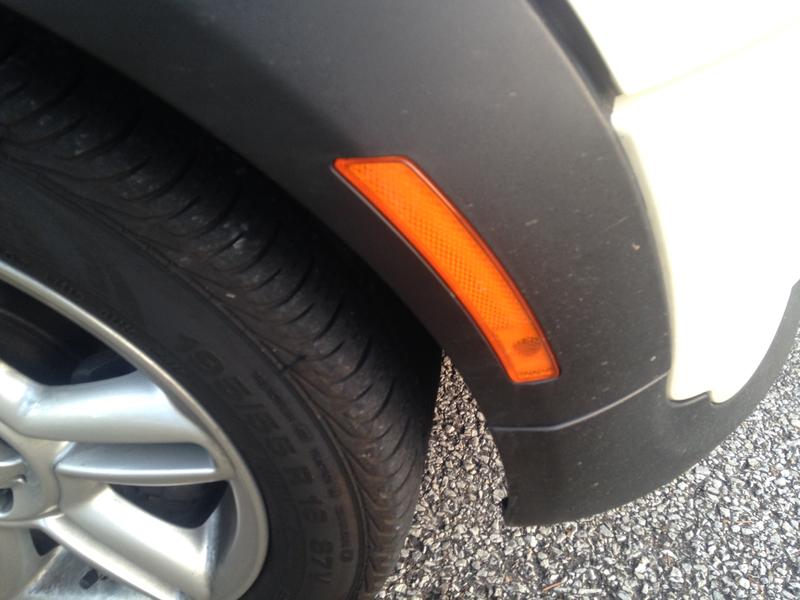

I have tried searching the forum for the answer, but I can't seem to find it anywhere... How do I get the fender reflectors off of a 2011 MCS? I want to remove them to do a proper tint. Thanks in advance.

I've only done the fronts as part of a bumper removal, but as as far as I remember:
Pull back the wheel well liner. You may need to remove some of the fasteners, there are about 5 attaching it to the back of the front bumper, and/or the big plastic circles that let you access the light bulbs, to let you get enough access.
Remove the light wiring (simple twist and pull).
Undo the pressed metal "nuts" at the top and bottom of the reflector. I've never done the rears, but it's most likely similar.

held in place by a 10mm unit (or 8mm, one or the other). Just move the wheel liner out of the way and find the nut and you'll be good to go.
