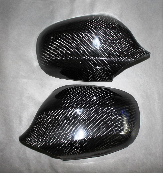

Here is an example of the mirror covers I did for my BMW a few years ago to whet you appetite.

Thanks...it is a talent that takes time to learn...I really enjoy working with carbon fiber though. I have used vinyl and even hydrodipping, but nothing compares to real carbon fiber.

They are skinned, overlays, wrapped, whatever your word choice is...It is very difficult to make interior parts that aren't overlays. In fact, BMW overlays their interior trim as does JCW...The clips and attachment points of interior trim is too difficult to duplicate...plus there really is no point in reinventing the wheel.
