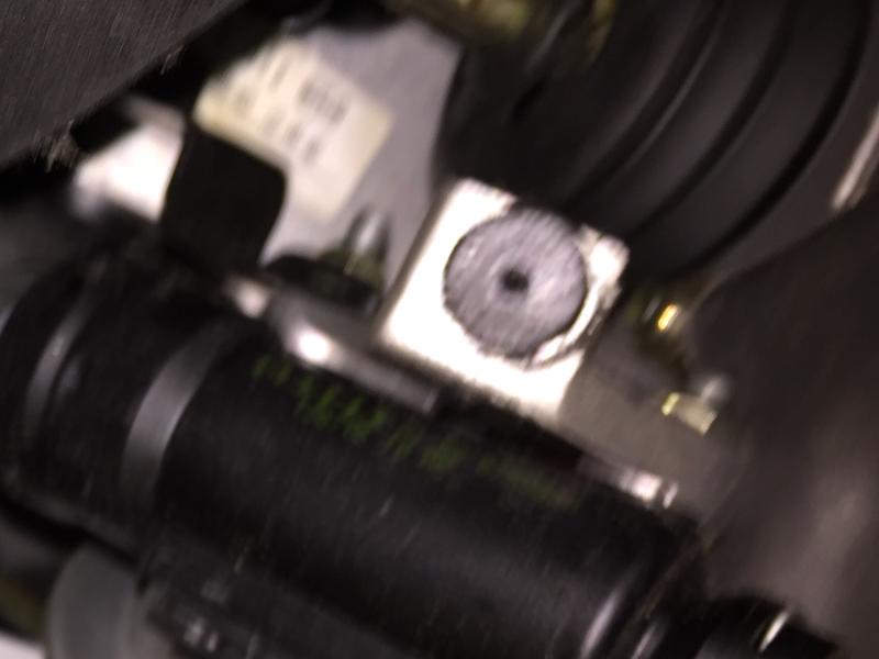

Has anyone tried this mod on a 1st generation MINI yet? It looks like it is feasible looking at the photo of my R53 clutch stop. The photo was taken from the floor board straight up under the dash. The stop is the silver piece with the black circle in the middle. Sorry it's so blurry, it's was hard to take the photo. It is not on the firewall like it looks on the R56 above.

I don't think you really need a part number. I walked into my local auto parts store and asked for the fender retainers. There was only one size. I bought those and went to Home Depot a bought a dozen washers that fit over the fender retainer. Have not installed them yet (115 degrees in the garage) but will as soon as it gets into the double digit weather.
