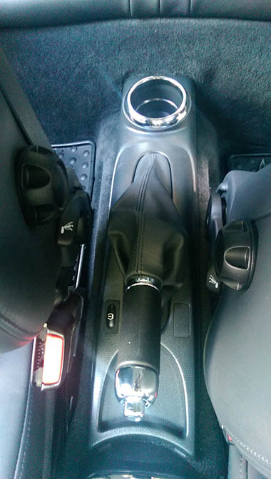

This bracket you had me purchase:
is not needed for this swap. In fact, it cant be used due to the controller that the flat tire reset button plugs into. Here is a picture of it with the center console disassembled:

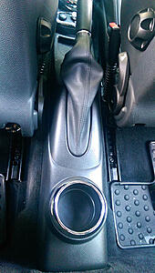

If you look at the diagrams you have above, you will notice that the original bracket has a large space to accommodate it. The new one does not and will cause people the extra headache of needing to remove the bracket, attached wires, and the straps that hold the wires in place. The new console cover fits perfectly over the old mounting bracket and looks quite nice:
It really just snaps right on with the original four plugs, the two tabs slide underneath the seat warmer console and you reuse the screw underneath the rear cup holder.
To mount the Euro armrest, remove the two inner torx bolts on the driver and passenger side seats in the rear and loosen the two outer ones in order to give you some room to lift the seat up and slide the armrest legs underneath.
