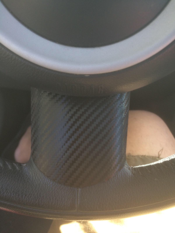

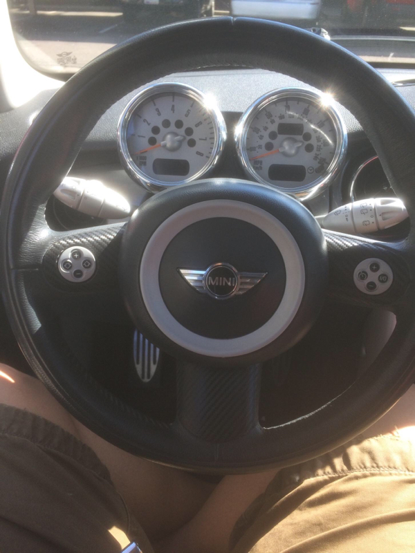

The trim pieces are actually really easy to remove. They are screwed in by one torx.
I had mine painted black and wrapped my friends in a carbon fiber wrap.
