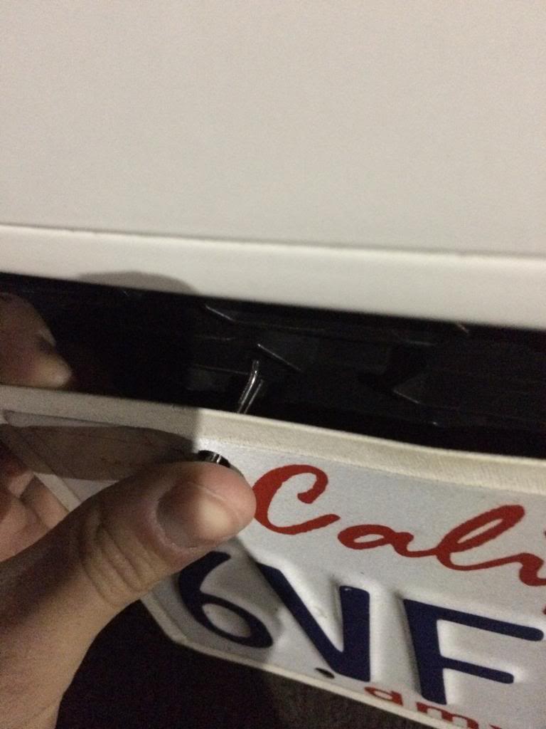

Therefore I've found a way to quickly attach my plate to my grille when I park and easily remove it when I leave. Thus abiding by their stupid law and saving me money

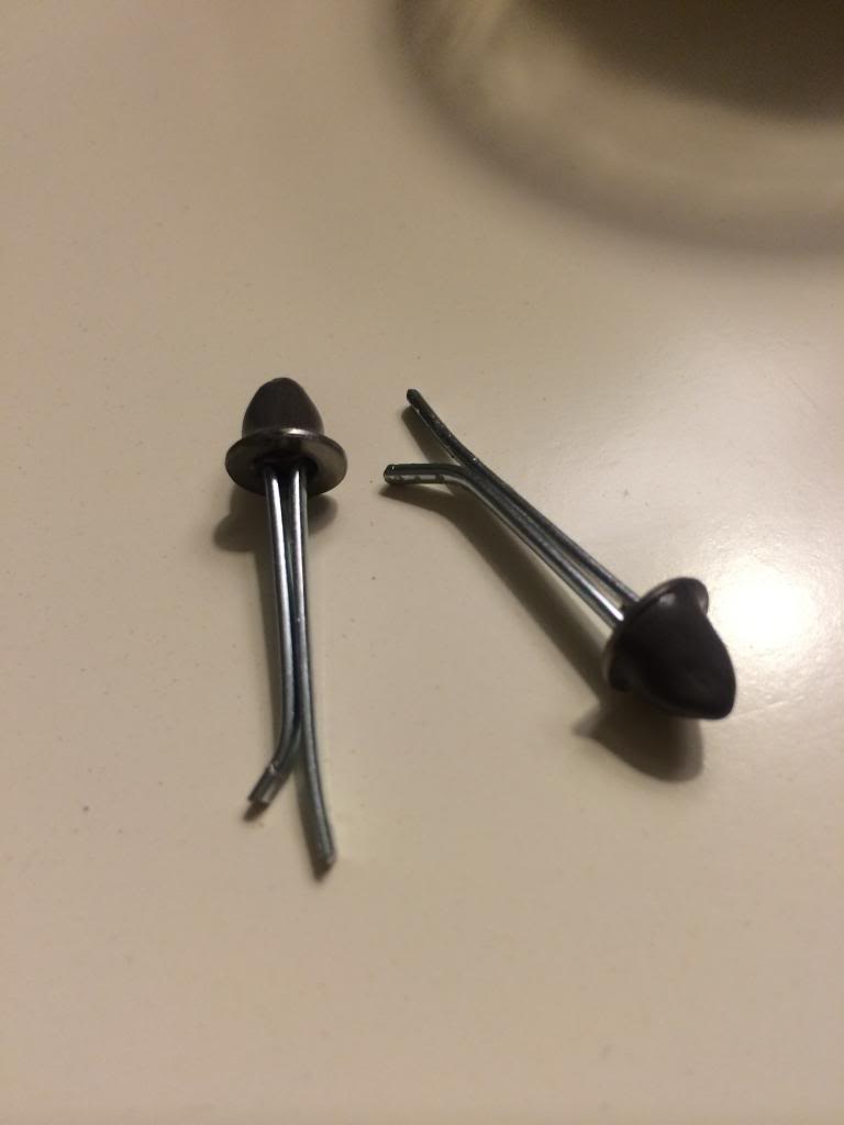

I grabbed a pair of cotter pins from Lowes and two small washers. Get washers that are large enough to not slip thru the bolt holes on the license plate but have a hole in the middle small enough that the round end of the cotter pin won't slip thru. I found my perfect pair, took them home, JB Welded the washer to the pin. Let it dry.

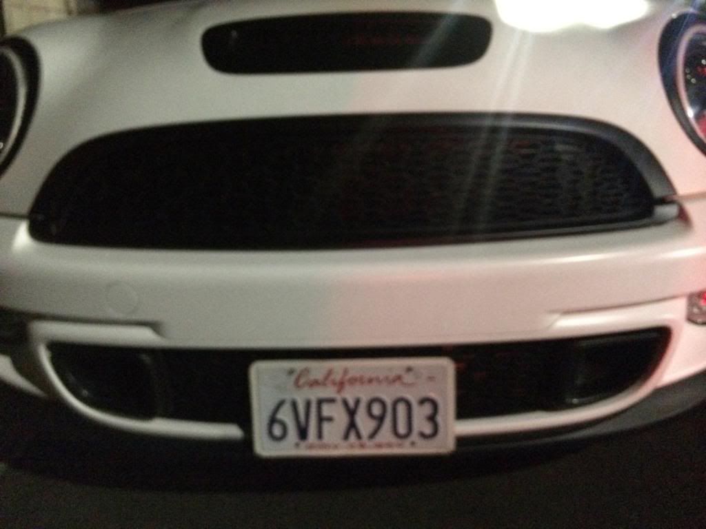

Now when I park, I just take the plate and clip it to the lower grille! It slips right on and stays. Then when I want to leave just pull it right off leaving no marks and taking only seconds. The cotter pins should be strong enough to stay in place even if you forget to remove the plate and drive off with it.

Yes but you can't easily remove the tow hook mount. My goal was to have an option where you can slap the plate on for street parking and remove it quickly for everything else. Also that costs $70, mine cost me $0.68
