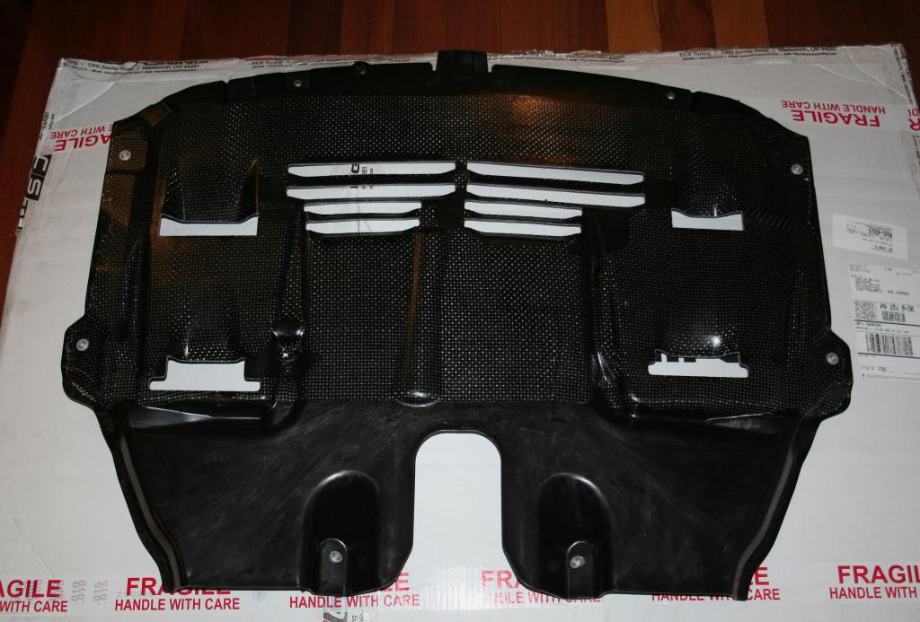

I installed it yesterday and I'll admit I may have been a little quick to judge.
It still is expensive but definitely worth the expense!
The belly pan is overall relatively flat so I still have my doubts on the effect of geometry itself has on aerodynamics. That said I can definitely see how they looked at balancing engine venting while minimizing air turbulence, so yeah, I've been a little quick to judge... I get your points
Overall, I'm very happy with it. Definitely worth it!
Install was a breeze. The hardware was easy to figure out. And once it's installed it feels solid which is great.

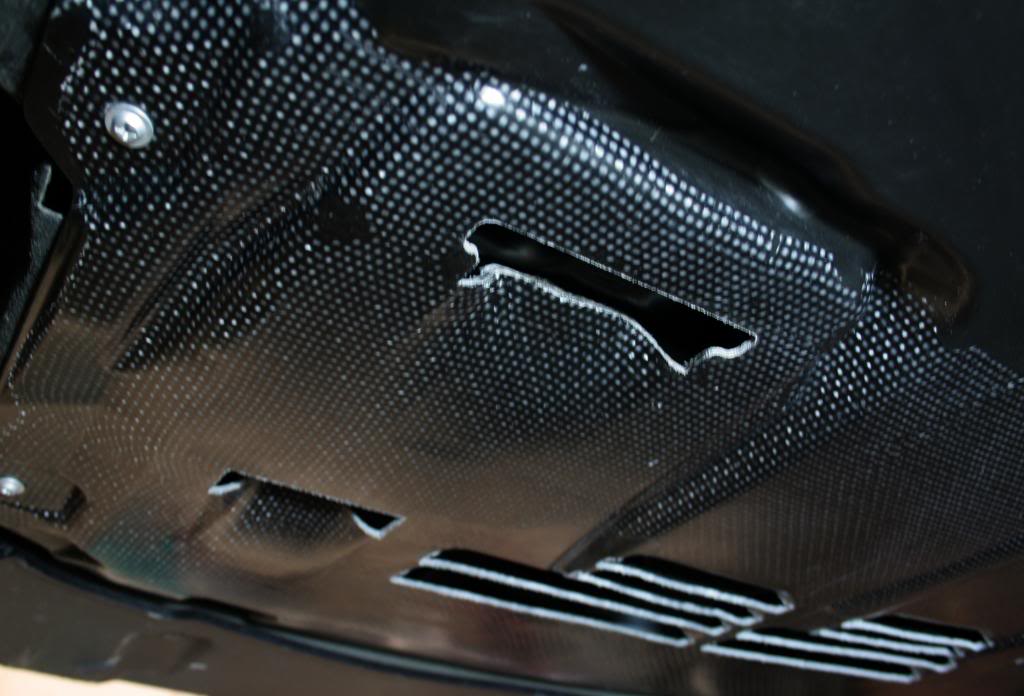

I decided not to trim the vent to clear the auto transmission, but rather I used a heat gun to flatten it a little. It worked very well though I should have warm it up more slowly and find a good quality wooden block and on both sides to get a better and straighter a finish. I was in a rush. We don't see it much anyway so I'm happy how it came out:
Very nice again. I like your heat gun technique, very interesting. And nice for people who don't want to shave it for the automatic transmission pan. The reinforced material does give it a carbon look a little. I am glad it was easy to form for you.
Yes, the heat gun technic is really the way to go on this. The main reasonto heat it more slo wly is to prevent the surface fibers from separating. With a proper polished piece of wood pressed from both side it would have been perfect to make this adjustment.
Trimming with a dremel would be a mess in comparison. The beauty is that it doesn't take much time at all. The hard part would probably be more to prepare the proper pieces of would. Something else could be used as well!

Quick pic of the installed part, overall it was very easy to install.
Just get the front of the car up a little on my homemade ramps, get the original 'micro splash guard' off, install the quick screw hardware & ready to go.
I decided to just dremel off the bit that touched the auto trans, a cutting wheel at high speed made a clean cut, the heat gun was taking too long for me(Xmas lunch was waiting)
