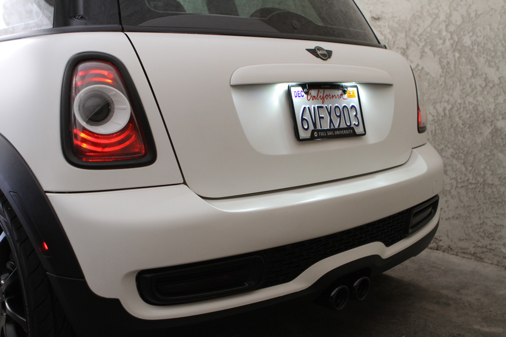

If you want a gloss black finish use Rust-Oleum Engine Enamel. The exhaust tips have a little screw on the bottom. Loosen that and the tips will pop right off. I just painted them with 4-5 coats and they have a great gloss black finish that matches my car great. I think they actually look quite a bit better than matte black even on my car.
