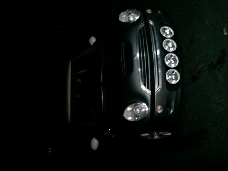

The lights are in. Basically followed the plan like a Uber install with Altar arrangement, I drilled holes also for the Uber setup, but decide not to have the gap in the center.
It was somewhat more customization than I anticipated - on top of drilling, it needs cutting too. For those who got an Alta bar before they are out of stock at a discount price - you got a good deal! If I was not lined up with a weekend of car wrenching and only want the lights, I probably would have ordered a kit from VIP or outmotoring.
The bar is working as expected, though shakers a little when going through bumps, but definitely not bad, I will add some dampings when more observations are available. For people want to DIY the bar, choose materials and building blocks with even more rigidity! - what was solid in my hand turned out not solid enough for cars. sub-millimeter movement will be observable when lights are projected. Don't know how the Alta and Uber compare.
I did also get tie rods, thermostat done. so after all, it was alot of fun and the weather was nice. I did not appreciate the complexity for getting the thermostat in, and for both tierod assemblies, I had to cut them off before the jam nut as they were rusted - using a hack saw!
For the lights, picture worth a thousand words. I was working by myself, and was pretty dirty and occupied the whole time, shots are limited but should deliver the concept. Attached are three photos. 1) light bar construction and mounting on the bumper plate. 2) and 3) are photos of the car with and without the lights on. Night visibility is greatly improved.

I took the car out after the brakes were done today. Stretch it abit while I was bedding in the new rotors, cooled down abit, and went through a car wash after a long wait. The engine was running the entire time and did not see any issue with over heating, it was in the 30's today in MN, and probably the best I can test on overheating before next spring - I personally would not anticipate any issues, and the Mini temp gauge really does not tell a whole lot either. Anyways, for now "working like a charm" is the conclusion. Cheers.
