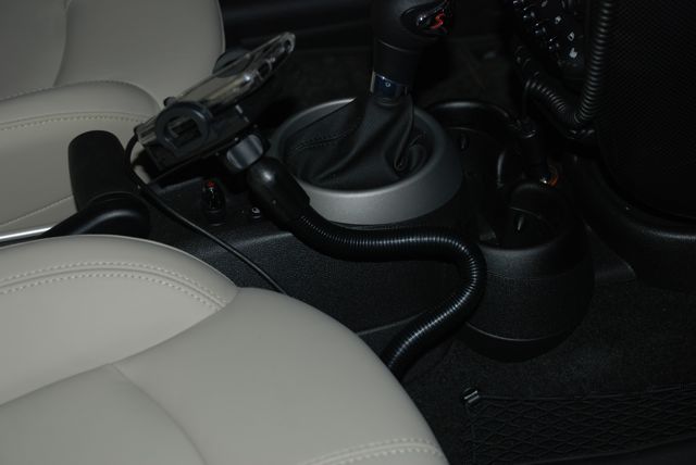

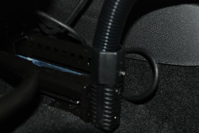

installed a floor based Arkon Mount. Bought it on ebay. It bolts to the front left seat bolt. You have to unbolt the front left seat from the car floor. I then had to drill open the bracket that came with the Arkon mount because the Mini seat bolt with star drive was a greater diameter bolt. It fit a 5/16 drill bit perfectly. Once i did this i bolted the bracket and subsequently placed the mount. I will try to take some pics over the weekend. I also use the DockXtender which allows full function of the y-adaptor. There are two lengths available 2 or 3 feet? and 6 foot. I got the 6 foot and it was way more than enough.
I will try to post pic and links this weekend if anyone is interested. It look and functions very well.

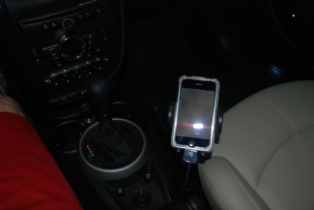

Dock Xtender
The Dock Xtender will extend the port on the Y adapter. Everything works fine on my 6 ft Doc Xtender (music, video, CONNECTED). It was a little pricey (i think like $30 + ) . MY Arkon Mount is on passenger seat not "left seat" as i discussed. I think i could have easile gotten by on the 2 ft extender cable.
Here is the mount: http://www.amazon.com/Arkon-Universa...6106931&sr=8-1
Here is the Dock Xtender 2 ft: http://www.amazon.com/CableJive-dock...sr=1-1-catcorr
I have attached pics. let me know if you need help. I believe i had to use the accessory (included) bracket attachment to fit the mini seat attachment bolt and had to drill out the appropriate hole to 5/16 inch.
