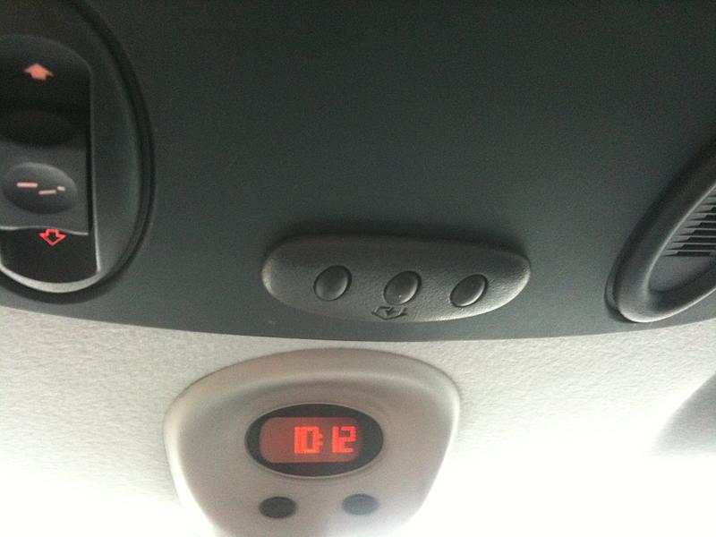

well i added the homelink unit.. cost 20 bucks off ebay for an all black one and i had the wire and inline splices.. definitely worth every penny. just watch for the depth of the buttons i had to add some height to the buttons to make it a little easier to push.. heres how it turned out.
thanks to the person who wrote this write up...

Old Apr 11, 2011 | 08:39 AM
chaseabryant's Avatar
chaseabryant
Joined: Jun 2007
Posts: 564
From: Boston, MA
Looks great!
