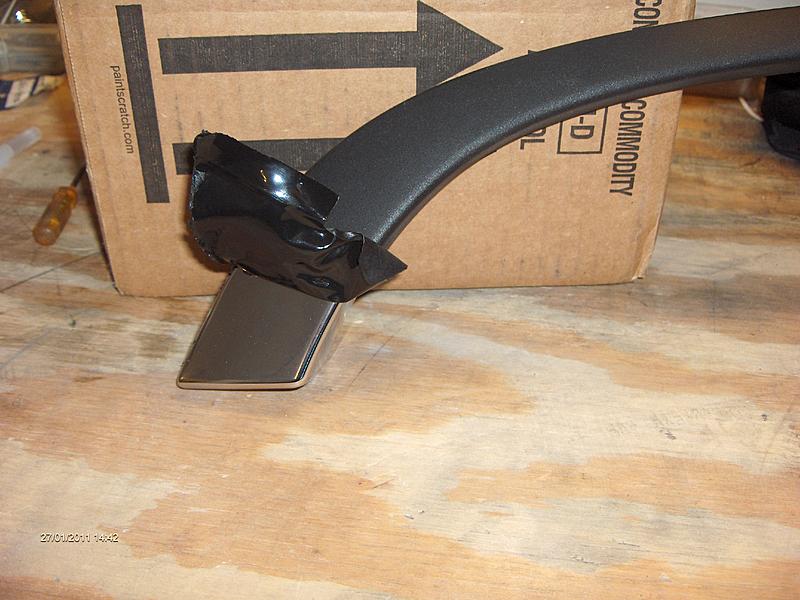

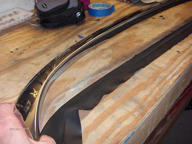

..I had done plasti dip a few months back, but was kinda not completely linking the way it was picking up pieces of my microfiber towels!
..I realize that I'd sprayed from too far away..which made it come out kinda ruff..
..so, I pulled it off (was easy) and re did it much more carefully..and it came out nice and smooth...I just spray TW Ice on it and wipe off..and it looks fressh and new after each wash.
here are some pics of how it peeled off the grill chrome, ....it looked kinda like a black snake...so I took it in to show (scare the hell out of) my wife, when she was in the shower
!! ...sorry..no pics of that
