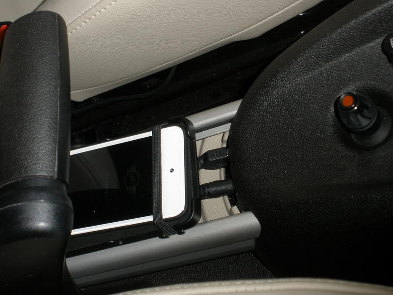

For those who are interested. I removed the two 8.75" black plastic snap in pieces that are located on one on each side of the rail track. They are there to prevent you from placing any rail accessories in front of the brake handle travel area.
My wife wanted to be able to use her cell phone holder that came with the car. I said that I would remove those plastic pieces and make it usable.
Granted, we will now have to take the brake off by gripping it from underneath on the rear side of the handle instead of the standard way. We'll see how long we like taking the brake off that way. With the handle down there's about half an inch space between the holder and the brake handle.
I used a small flat blade screwdriver placed at the exposed end of the insert facing the rear of the car to pry inward toward the center of the rail. As you can see in the pics, it is open on one end with a lip on the top and bottom edge that keeps it snapped into the rail. Just place the screwdriver blade so that it fits into the slotted part of the insert. I recommend prying the passenger side insert from the driver seat and the driver side insert from the passenger seat.
For those who use their radio aux input jack or the usb, don't bother attempting this because as you can see I am almost up against the jacks.
Depending how much much of a p.i.t.a. it is to release the brake handle that way, we may opt for a different type of cell phone holder.

Nice job! Been wondering about this. My car is off a few months but I'm bugged by the fact the area was so cramped. So per above, do you mean you would grab the brake like you would curl a dumbbell (sorry, only thing I could think of) so your hand is turned over?

My wife has been releasing the brake by reaching on the driver's side of the handle. I take two or three fingers and reach with palm side forward from the rear side of the handle.

This is a great start. Knowing how to remove the strips. Now we need a retrofit of the holder to raise it out of the way of the brake handle.
I removed the cell phone holder from the base where it rotates. To do this unmount from the part that clips into the rail turn it over and squeeze the two clips together that come through the base it is hard to do but it will pop out.
Now what I plan to try is to reattach the pieces with a 3-inch or so spacer. This gets the phone higher and if the spacer is small enough in diameter will allow enough room for proper gripping of the brake handle. Not sure how to do this without damaging the pieces. I am going to think on this. Any suggestions or comments are welcome.
I will try a test fit in the Mini tomorrow for diameter and height. Also need to worry about the 6 speed. I don't want finger crunchers on that side too. Be careful when you have a large cup up front.

Nevermind. The space is just too close for a good mount of the cell phone holder in this location and a forward grip on the brake.

we pulled the phone holder out from that position a week ago.....too much of a pain
