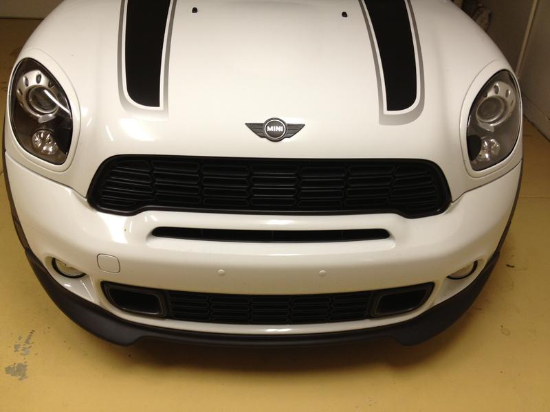

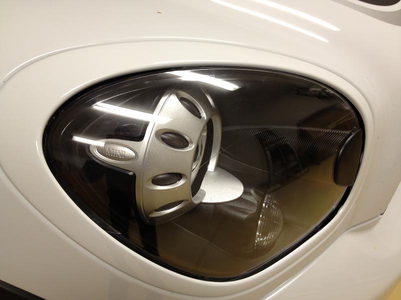

Alright, here are the photos of my Joey mod. I already had the black headlight housings from the factory, so all I planned to do was paint the projector ring and shroud a different color. I thought about doing a dark gray, but ultimately decided to go with a silver color ("Aluminum") to match the stripes and make it look like real metal. Mostly, my goal was to get rid of the last bit of chrome on the exterior of my car. (I even removed each "S" on the scuttles and painted them silver.)
Someday I might paint the black parts a dark grey to lighten it up a bit, but it will definitely do for now.

Great look!

they came out great.
and the vinyl on your rings is a freakin' dead light white match.
