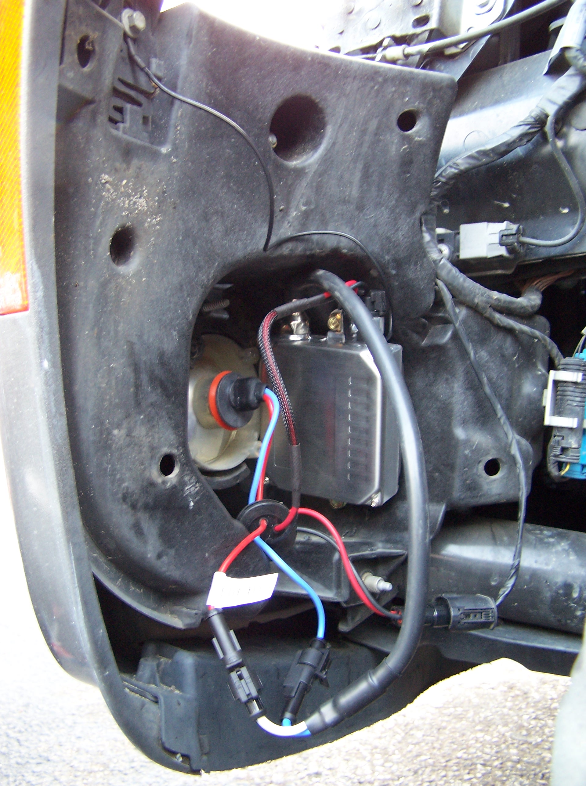

Fogs were another thing, where to mount the ballasts and eliminators?
First the parts from ddm don't come with any instructions but everything is plug-n-play and so simple to figure out. Everything else is super easy.
All you have to do is turn your wheels as far as you can to the outside of the side your.
working on. (working on the right side, turn the wheels all the way to the right.)
Pull 3 or 4 of the inner fenderwell plugs out.(4 makes it a little easier but not ness.)
Simply unplug & remove the old bulbs.
Plug all the components from ddm together (bulb-ballast-eliminator)
Insert the new bulb into the fog light housing.
Now for a nice suprise. Everything tucks neatly into the space behind the fog light. (a
little touch of silicone helps to hold the ballast and eliminator in place but it's
probably not ness.)
Plug the factory connector into the new receptical.
Put all your fenderwell plugs back in, and your done.

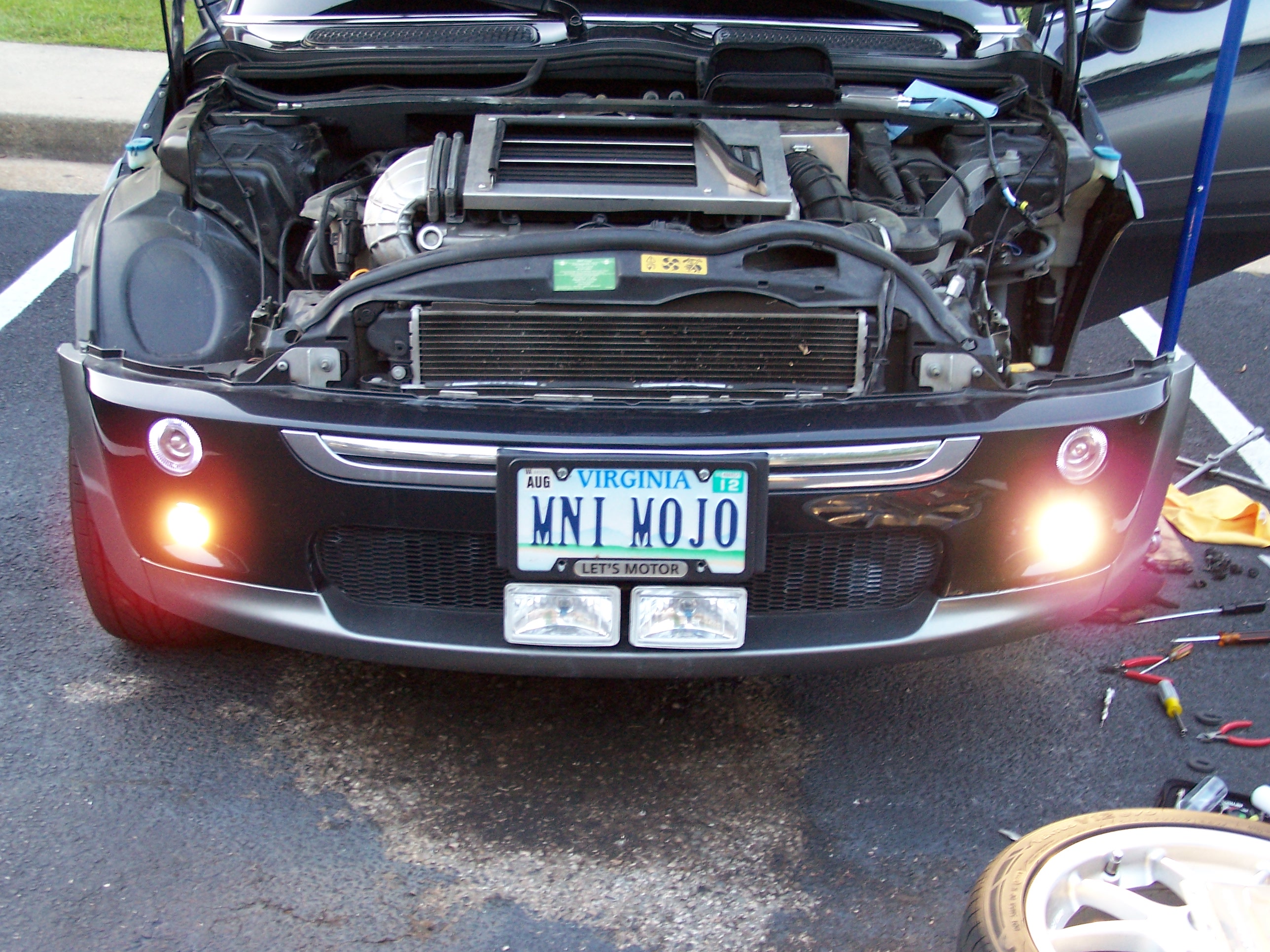

So I picked up my set. DDM was fast and care free. No extra cost once I got it. (Canada) will deal with them again. Then install was super easy. Took all of 30 minutes.
Here is a pic

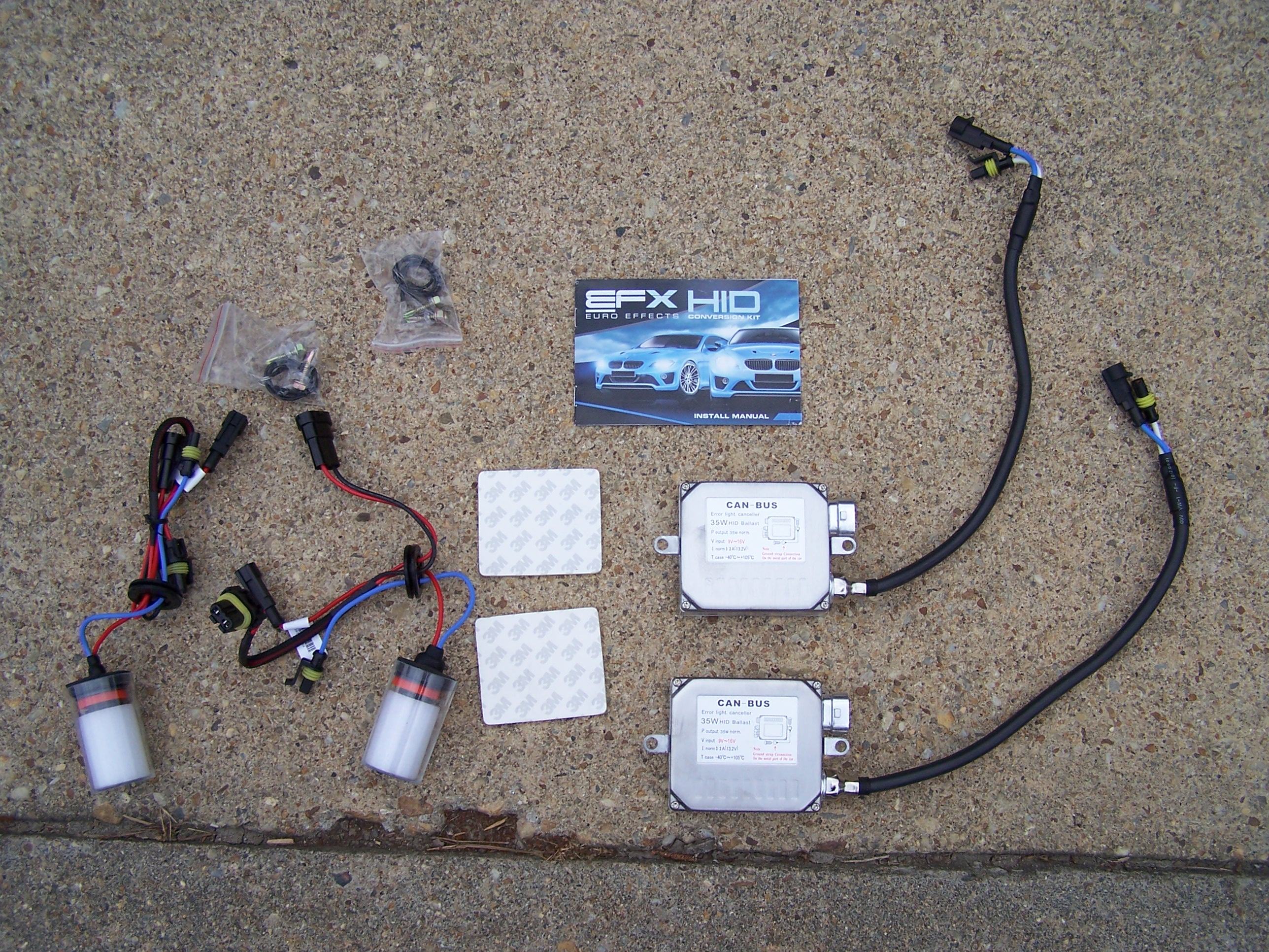

I've read this article before, but I forgot about it. I sent DDM Tuning two e-mails on advice as to what I need, but they never wrote me back. After I reread this info, I went to their site and was about to buy the kit. But... they don't do 2-day shipping anymore! I wanted to get the kit in time for MOTD next week, and the normal delivery schedule was 7-10 days.
So, I did some more research, and I also rebrowsed the various kits/options on E-Bay. I settled on an EFX HID 35W 4300K kit for $117. Now, this one is more expensive because it comes with CAN-BUS ballasts. They are specially designed for BMWs and any other manufacturer that uses this bus. These ballasts are supposed to have the appropriate resistance built in, which eliminates the need for the error code eliminators.
My kit should be in this weekend. I will repost and let you know how they turn out.

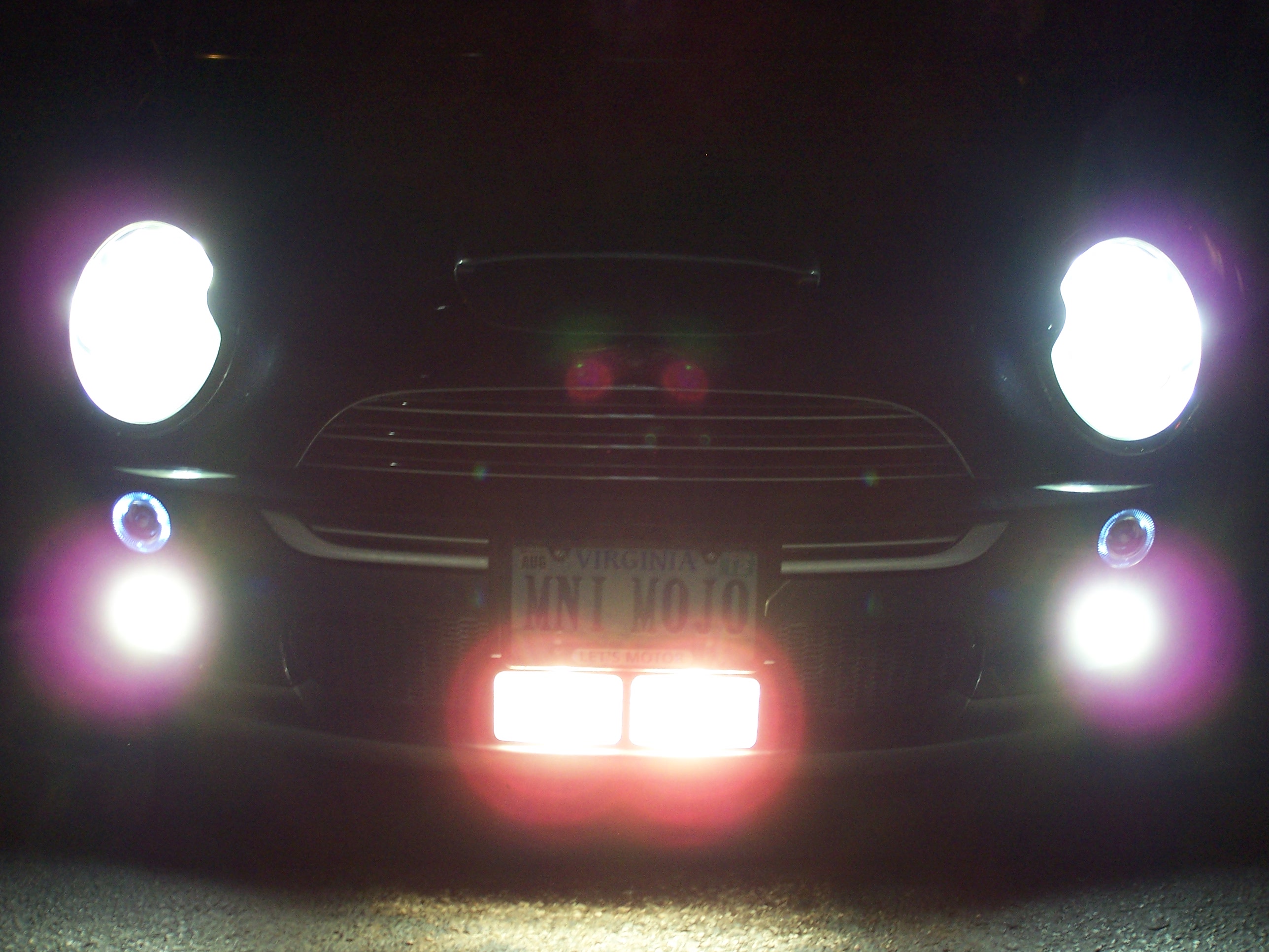

Well, finally finished my last lighting project, first of course it was this hid upgrade, then it was the change to projector fog's:
https://www.northamericanmotoring.co...og-lights.html
Then the led's in my projector surrounds:
https://www.northamericanmotoring.co...eadlights.html
Now I've modded a pair of Black Magic driving lights to accept hid bulbs, I had to heavily mod the lenses due to the hid bulbs being longer than the standard h3's. I purchased a 55w hid kit w/ 8000k bulbs to match all of my other lights.
Since I had factory driving lights I already had a switch in the panel under the steering wheel, but of course this switch is hooked in with the high beams and I really wanted to be able to use them anytime, not just with the high beams, so I decided to go old school:
Relayed it in to the ignition so I couldn't accidentally leave them on.
These things are really bright, they'll be great for this week on the dragon.

I got my kit installed tonight. Was well worth the extra $$$. The ballasts are rated to handle 9-16V, with nominal 13.2V. They're thick and meaty, too. The Xenon bulbs don't match 100% to the factory color, but they are definitely brighter. The 3rd picture is supposed to compare factory (left) vs. HID (right) facing the MINI. The last picture is just where I turned on my driving lights. They are 100W blue Xenon look-alikes.
