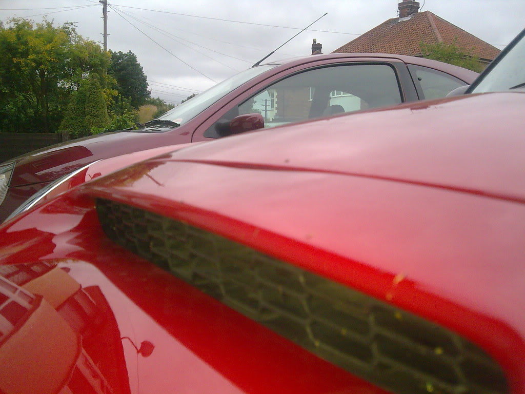

Does anyone know where to get one that they use in the German MINI Challenge series ?? Mine has just started to warp so am looking for alternatives - I would rather vent the air than trap it in though...

Old Jul 26, 2011 | 12:51 PM

Not good! Definitely early onset hood scoop warpage. It's all down hill from there. You need a heat shield. BTW,the Challange cars have a big deflector under the hood that is attached to that scoop. Deflects the air down onto the turbo.
Good Luck
Yeah it is a bit annoying - have dropped a message to a dealership over here to see what my options are (still have 2 years of warranty to run on the car) so am hoping there may a couple of options... Im kinda hoping I get offered the JCW carbon scoop so I can sell it and then put the funds towards the challenge one
Dont want a heat shield as that will just trap the heat = not dealing with it properly. I want to be able to either vent it or feed cool air to stop it happening...
Yeah, seen that deflector not sure if it has to be fitted or not - those grills on that scoop kinda imply that it could suck air out from under the bonnet too...
