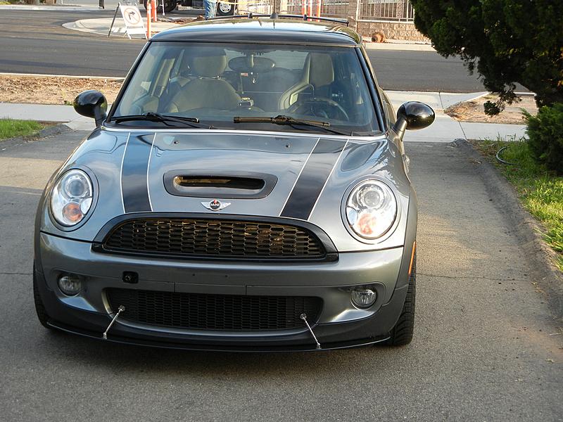

Put the splitter on myself. Just search NAM for how to remove the front bumper. Took a few hours the first time to put on, but after I did the first one, only about an hour to take the bumper off and back on (when I put a larger intercooler on). You may notice I didn't want to drill a hole in my front bumper, so I used the grill as a mounting point. Just reinforced the back with a couple fender washers and no problems so far.
Finally got my splitter and have some questions about your mounting technique. How big are the fender washers you used for support on the backside of the grill? Also, the mounting instructions are just a little vague. I assume that once I drill the splitter for the 8 mounting bolts, I use the splitter as a template to mark where to drill the bumper mounting holes. Right? BTW, I got 2 different size washers for those bolts! UFF DA!
Thanks for any help - DW

I bought my M7 splitter used from the "Market" on this website. So I didn't have any instructions other than what I downloaded from the M7 website. I just removed the bumper skin and set the splitter on the bumper. Then marked the holes to line up with the stock bumper and drilled away. All the washers in my kit were all the same.

Right in the middle of the splitter install when I realized that once it's bolted in place the 2 Torx bolts and 3 pop-its cannot be re-installed to secure the bottom of the bumper cover to the car! Am hoping the added stiffness of the splitter will compensate for this. Hope I'm right as I'm about to start drilling holes. The splitter only seems to fit the bumper cover one way. BTW, I ain't calling the maker for "advice"!

Took all day, but I finally got the splitter on. No "spare" parts laying around and only moderate blood loss, lol. Still have to set the angle on the splitter and put the plate back on, but that's for tomorrow. Thanks for your help on this. Without it I'd have been lost. Here's a couple pics.
