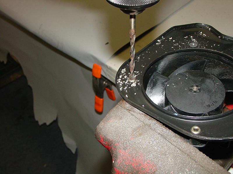

The circular black things are rivets. They must be drilled out or ground off. (They essentially mushroom out on the other side of the metal, so once the head is off, the bracket will come off.)

Okay what kind of drill would i use to get that off? and once i do get it off is it fine to keep the wiring there?
Just size the drill bit to be slightly larger than the *hole* of the rivet (NOT the head) - you can always drill a larger hole, never a smaller one.
If you're in doubt, I'm sure any shop would pop them off for a few bucks. Just make sure you don't drill through the rivet and into the surface of the bonnet!
The wiring should be fine, though I would zip tie the now loose ends somewhere on the bonnet. You could remove all the underhood wiring, but I'd suggest leaving it in case you decide on lights later, or sell the car.

Here are some pictures from replacing the power steering pump and fan. In the picture, you can see that the fan is held to the frame with rivets. I'm drilling out the center of the rivet. The drill bit should be slightly larger than the center of the rivet, but smaller then the outside rivet head.
