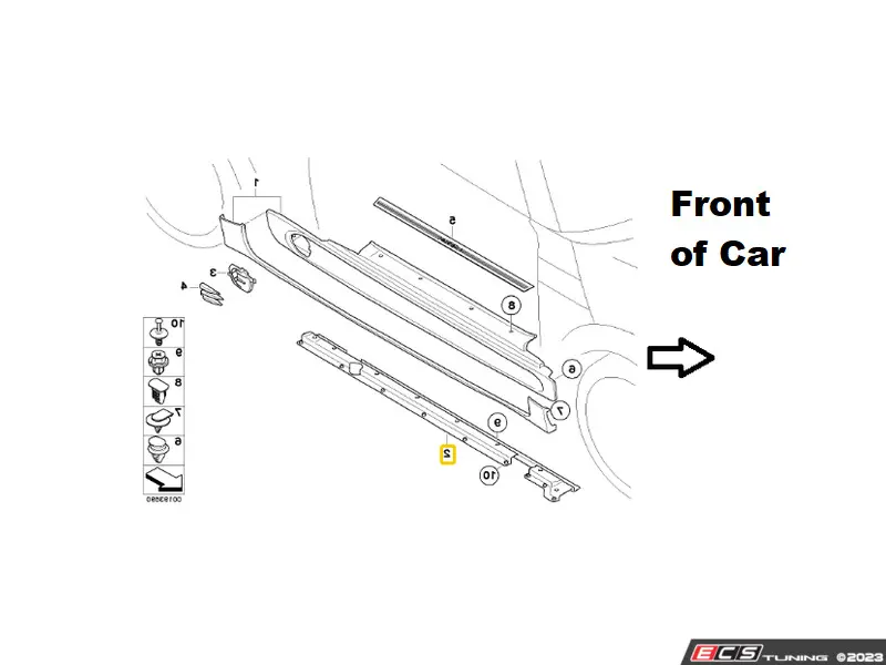

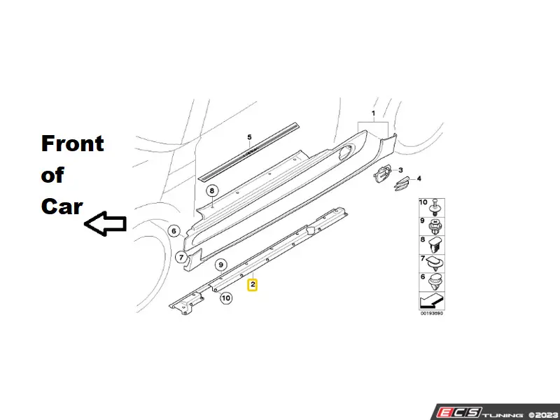

The aero side skirts for 1 gen and 2nd gen share exact same parts you can't see. If you want to add R56 side skirts to R53 you need get the aero mounting sill adaptors and then all mounting points under the car will match up. Trimming will be required for kick plate area due to slight differences in door sill ends.
Get door sill adaptors right and left side about $31.00 per side.
Part no # 51 71 0 413 260
Part no # 51 71 0 413 259
Then will just need the standard hardware for aero kit installation for R53, runs about 30 dollars a side for clips and hardware.

Looks like this : 51710413260 51710413259 for the R56 to R53 conversion.
https://www.ecstuning.com/Search/Sit...h/51710413260/
https://www.ecstuning.com/Search/Sit...h/51710413259/

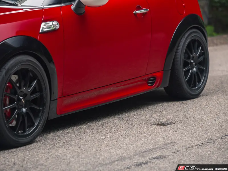

Late to the game, but this thread really helped! With the adapters, everything snaps into place no problem. There's really nothing you can do about the fender trim not being as wide, but IMO doesn't really matter.

Just an update those 2 parts are now NLA from MINI 51710413260 51710413259 and only available at ECS now in aftermarket! Linked above. We just landed more stock.
If you have the side skirts.
Otherwise get this full kit with them.
https://www.ecstuning.com/Search/Sit...w_side_skirts/
