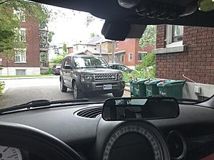

Thanks for this thread. Gave me the courage to fix this annoying detail. 99% of my driving is downtown. At 5' 11" I have a hell of time seeing pedestrians and traffic lights with the factory mirror in the way.
I decided to go straight for the hot rod look. Managed to find a basic 8" x 2.5" mirror at the local auto parts store. I used the adhesive strip as well as screwed the base right to the top of the cluster, and so far there is no real issues with vibrations etc. Nice and solid. Easily as solid as the original mount.
The view out the back is perfectly fine. Since its a Clubman, there was always the split door portion blocked, but since the car is so low to the ground and basically everything else on the road is taller than it, the mirror is ever so slightly pointing up rather than down if it were on the headliner. Still can pick up cars at least 85% of the distance back as I could with it up high. More importantly, other than the cover for the rain/daylight sensor (I removed my parking pass after the photo), the windshield is completely unobstructed, from the top clear to the bottom, including the hoodline. It is perfect!
As a side benefit, I can also now keep an eye on my toddler in the backseat.

Nice work Scotty. I too considered mounting a mirror on the dash.
And yes, I remember the revelation at being able to SEE thru all that extra windshield. Made a big difference.
Glad I could help
Bill
