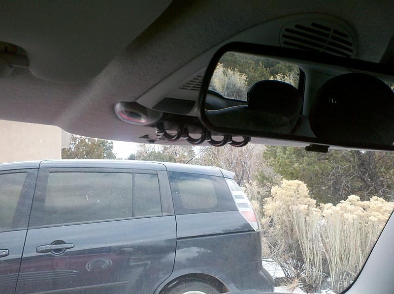

See pic for the looks of where the old mirror was. It's not very visible from any seat in the car, and invisible from outside. That said, I'm thinking about putting perhaps a MINI badge over the hole...same thing I'll do where the replacement mirror is attached...when I remove it, there will be a small screw hole, so I'll pput a MINI badge or some such thing over the hole.
But if I sell the MINI privately, I'll ask the new owner if he wants the replacement mirror removed...I'll be he won't.
For those who say the factory mirror doesn't bother them, they should check the view with their mirror removed...go for a short drive, etc...it really is a big difference.
As far as other mirror possibilities go, I looked and looked...the best possibility I came up with, besides the one I used, was to get a boat mirror (from a boating website)...the kind that mounts from BELOW and stands up on a dashboard.
I've also seen that type in a few older roadster/cars from time to time...can't remember which models...anyway, screwing something like that down into the top of the dash would probably be a very nice solution...would look very classic.
Check this website for a couple nice dash mount possibilities:
http://www.cobrarestorers.com/
...click MIRRORS.
The round chrome one might look really cool sitting right above the MINI speedometer. And there is another one there that is more traditional.
