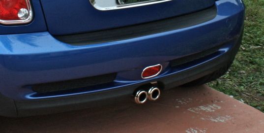

Are there such items available as stainless steel rear grill inserts for the 06 MCS?
Something the does not require removing the rear bumper?

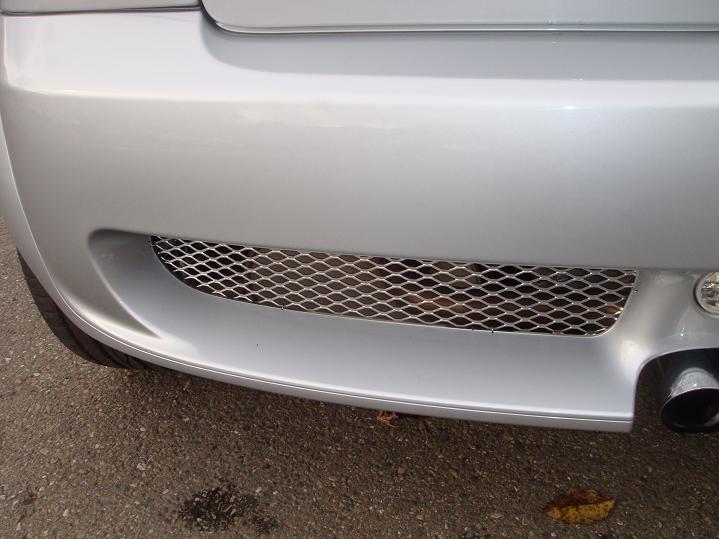

I did the same mod as Capt BJ is talking about. Did the same on mine. Used Chrome spray paint and wire harness to the bumper
