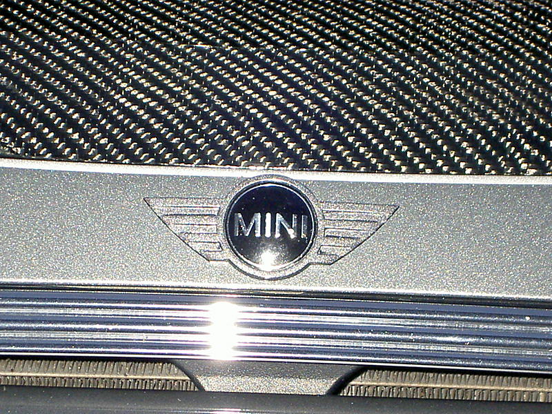

Not as easy as that unfortunately
Here is what it looks like under the badge. It would require some body work for the holes underneith....The badge is secured with just 3m tape....no other attachments. I used dental floss to work at tape from all sides. Other badges (COOPER S) have no holes and dental floss takes them off nicely. Just use some MaGuires liquid auto polish for any tape residue. Dab some on, let it sit for a few minutes and let it work on adheasive. Then rub out/off remaining tape residue....plus no harm to finish either.
BTW: I just painted parts of my front badge OEM Dark Silver..... Now it rather blends in nicely....
