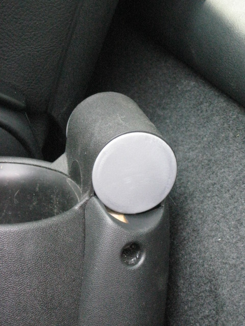

Pete at Minspeed advises that separating the old armrest from the console will leave two 1.75-inch-diameter holes at the armrest hinge-points. Apparently, there is an alternate "console" that MINI sells without those holes for around $65 ... ORRRRRR, you can "go to AceHardware and buy a couple of grey plastic furniture plugs for $2" -- looks almost pro.
When you put the two plastic halves behind the cupholder back, it's actually very easy to get them to stay together IF you cut and insert a small block of wood the same width as the bracket you just removed ... one wood screw on each side into those two holes to hold it all together, and voila! -- just add the plugs and you're done.
