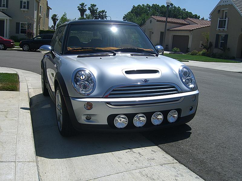

You can run four lights and a front plate. Ditch the black mount and move the plate so that the bottom of the plate screws in where the two top holes were. Here's what I mean with PU bar and a europlate:

The Palo Uber bar does not come with the lights and it will not work if you have an aero kit. Their reputation is not too stellar, but the light bar is probably the one thing they do have that is an exceptional product. It bolts to the front using existing bolts so there is no drilling and it is mounted down inside of the bumper so it is not visible. The wiring harness it comes with makes it very easy to wire also. I used the Hella 500's that I found on ebay for a great price. We had this bar on the car until we switched to an aero kit and loved it. It was so strong that the car could be lifted with it. It is the one product that Palo Uber got right.

very nice
