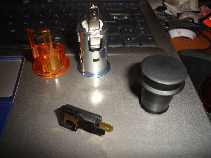

Part numbers through Classic:
51-16-7-052-720 = Luminous Ring ($2.60)
51-16-8-222-183 = Plug ($1.45)
61-34-6-915-065 = Bulb socket ($3.02)
61-34-6-973-035 = Cigarette Lighter ($3.24)
63-21-7-167-000 = Bulb ($2.08)
Total = $22.39
If I remember correctly, I didn't need the bulb. I think it came with one (bulb socket), so now I have an extra... These are all the parts. The only thing you'd need is your wiring and fuses... Also, DO NOT ASSEMBLE, before you put it on the car. I had one hell of a time disassembling everything...

How it all attaches...
The ring light slides over the cigarette socket, that should "Click" into place. Slide both of those into the hole in the boot. (As I mentioned before, only do this when you are installing into the car. I was dicking around with mine and had a hell of a time getting the pieces back apart to install in the car...) Once those two pieces are in the hole, you'll have to reach in through the little cutout in the trim (the panel you removed) and you'll want to attach the light bulb socket to the ring light (orange) piece (spade connector facing the same way as the ones on the cigarette socket). And that's it. The middle spade on the socket is your (+), spade on the outside is (-). The spade on the light bulb is (+) as well. If you notice the brass in the bulb socket, that's your grounding point (so this is why you only have 1 spade (+) on the light bulb socket.
Hope this makes sense.
BTW, if you pull your light bulb socket apart, you should find a bulb already inside (IIRC, the little black tab allows it to slide apart). Mine came with one installed, and I ended up having the one I thought I needed, left over...
