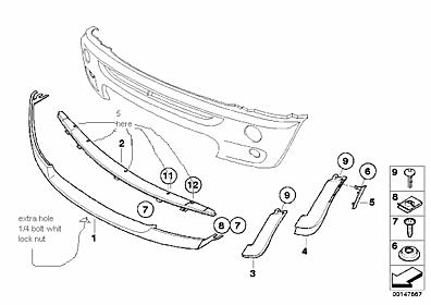

Here is how to ..

this is how i made it
Hi yes you line up the page and stik d'em togeter you will no have you template.. follow the number.. i have use 1/4 marine plywood and have put 2 coat of epoxie sand'it and went to the local paint shop to paint'it black.To secure the spliter i used 5 longer screw not to long not to damage the AC rad and 1 bolt 1/4 in bolt whit look nut to secure the the spare hole on the spliter and 2 turnbocle plus blue looktite on every screw..ps you have to remove the bumper for the intalation((turnbocle)) note that the turnbocle are only held in the platic of the bumber..and 2 1 inch washer are instal on each side off the bumper...and yes i have put 1 foot long off double face 3m tape in between bumper and the spliter (center)..I have brought the car to hight speed and the spliter is stil there..
