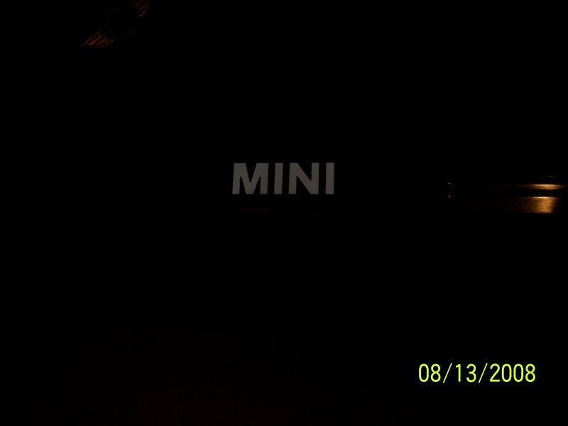

Following Getting Grey's lead and terfiffic connection instructions, I finally decided to tackle installing my illuminated door sills. I got a great deal on some basic MINI lighted sills from Classic Mini but my dealer wanted $650.00 to install. I was able to download the PDF install instructions for the R50 and these helped with giving me a general idea of what needed to be done but the R50 has the fuse panel on the driver's side and of course the circuits that you would connect the power and control wires to are different. Well GG solved that mystery so I got to work.
First off, I disconnected the negative battery cable so that I didn't fry myself during this process .
First you have to pull the rubber door seal out to expose the lower sill panels. I was expecting the seal to be held in place by some sort of adhesive but it is just held in with friction. Once you expose the lower door sill panels you can basically just slowly pry them out as they are held in by clips. A T-50 Torx bit is required to remove the lower seat belt anchors which secure the back end of the lower sill panels.
Removing the existing sills was very easy as I just stuck a slot screwdriver under the edge to pry it up then just pulled it up. There was some residue from the double sided adhesive tape that is used to secure the existing sills . Removal of that required lightly saturating it with some Goo Gone. I let it set for about 15 minutes then came back with a razor blade and it came right up. I then cleaned the area with some alcohol.
I started on the passenger side of the car first
The next step was to drill the holes to run the wire coming out of the new door sills into the car. An 8mm bit is required but it is a good idea to use a smaller bit to drill a pilot hole. When drilling the inside sill you actually have to drill through two layers of sheet metal. It is very important to keep your drill level to keep your holes lined up. The hole going through the outer sill where the new sills are attached only has to go through one layer of sheet metal but must be lined up with the holes you drilled on the inner sill. You also have to open up the hole on the black plastic part of the outer sill in a slightly larger size to accomodate a grommit that is put in the hole of the sheet metal on the inner and outer sills. The grommits prevent the wires from coming in contact with the sharp edge of the sheet metal. The outer sill is secured in place with four clips that you have to twist 90 degrees to allow you to pull up the outer sill to drill your hole through. Now the tricky part, getting the door sill wires through all three holes. To accomplish this I used a zip tie with a opened up paper clip looped through the open end of the zip tie. The paper clip end is pushed into the inside sill holes. When I saw the tip end of the paper clip appear in the outer sill hole, I wiggled the tip up enough towards the hole so that I could grab it with needle nose pliers. I then pulled the clip up through the hole until the open end of the zip came through the hole. Before moving on to the next step, I vacuumed up all of the loose metal shavings from drilling the holes.
Before attaching the sill wires to the zip tie that was protruding through the hole of the outer sill, I slipped one of the grommits over the sill wire. I then attached the lead ends of the sill wire to the zip tie with electrical tape and pulled on the zip tie from the inside sill until the sill wires appeared through the hole. I then pushed the rubber grommits into the holes so that the wires would be safe from coming in contact with the sheet metal. The same process was repeated on the drivers side. I then opened up the wire harness that came with the sill kit and spread the wires out so that I had the proper wires going to the appropriate sides of the car. On the drivers side, I had to remove the lower side panel that is attached to the center dash stack and also the lower dash panel under the steering wheel. The removal of these pieces required a torx-20 bit. I then ran the red power lead end and passenger side sill connection up behind the dash and over to the fuse panel and sill wire. I then made the sill connection and attached the red power lead to the violet/grey wire located in pin 8 of the blue connector on the fuse panel using the provided self-piercing wire connectors. On the drivers side, I made the sill connection, removed the control module from the two studs holding it in place, disconnected the lower wire harness, located the brown/yellow wire located in pin 35 and connected the red/black control wire to the b/y wire using the self-piercing connector. Finally, I attached the brown ground wire to the grounding clip attached to the inner lower door sill. Before securing all wires and buttoning everything back up, I reconnected the negative battery cable and SUCCESS, my sills were glowing.
Finally, I put everything back together and cleaned up my car.
Overall the install wasn't that difficult but it did take me 4 1/2 hours due to the fact that I took my time with the installation so that I didn't make any mistakes. Now that I've done it I feel I could easily shave 2 hours off the install time.
These things look awesome. I do kind of wish that I had gone with the sills that said MINI COOPER instead of just plain MINI, but hey I was trying to save some $$$ because I thought I was going to have to pay for installation.
I do have pics of the install and finished product but due to picture restrictions, I can only upload 3 pics to this thread. If you are thinking about doing this yourself and would like to see some more installation pics, PM me and I'll gladly send you more pics.
