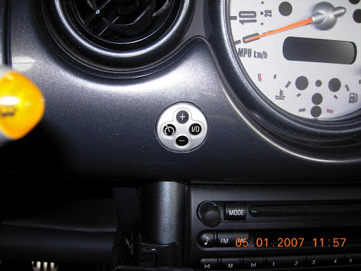

I just went through all your pictures in your website link and I must say that your mini is one of the sexiest mini's ever man... did you install this, im guessing cruise control, after the mini was purchased. please explain.
Old Oct 2, 2007 | 01:46 PM
  #99
ChrisMCS04's Avatar
ChrisMCS04
Peace Keeper
Joined: Dec 2006
Posts: 2,747
From: Defiance, Ohio
I think that is because he has a momo steering wheel. He relocated the MFSW buttons.
Sorry Nate, did not mean to speak for you.
