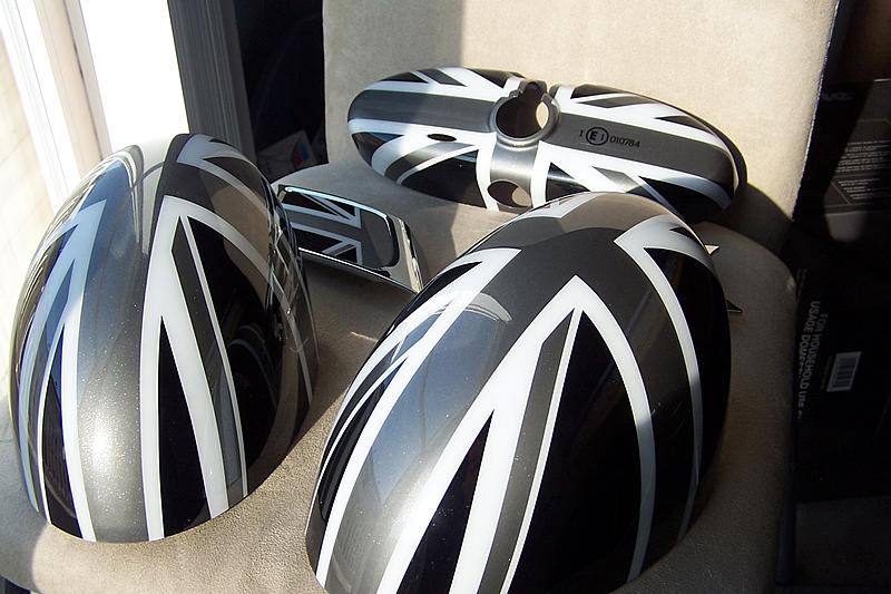

BlackJack covers installed
Ok I finally was able to get some pictures so here are my Black Jack Covers installed.
