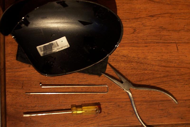

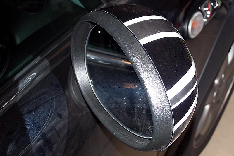

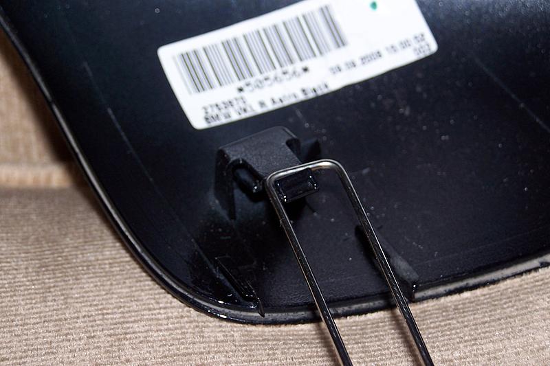

I have a 2009 MCS w/powerfold mirrors. I tried using the pull off method first as all the feedback seemed good. I pulled very lightly and nothing..so I reread the post and tried again pulling a bit harder this time and pop! Off came the mirror, unfortunately the mirror cracked and one of the mirror tabs broke as well. So very frustrated and angry i replaced the cap and put the mirror back on. I'm not sure what I did wrong, maybe something I have is different then what everyone else has that tried this or if the fact that it was about 40 degrees had something to do with it??
So now I go to the other mirror. I'm not even going to try the pull method this time as I really don't want to pay for two new mirrors (god only knows what that will cost me, and arm and a leg?) so I decide to try pressing the tabs. Using the new mirror cap for a guide to where the tabs are, and a flashlight I begin my task. I quickly decided to make my own tool to do this and create my own method. Amazingly it took about 10 minutes and that includes making my own tool. This is what I did:
I used needle nose pliers to bend a old spoke from a bicycle wheel, I made the end the with of the tab.
I then started with the top tab closest to the mirror, as I pushed down i pulled with my hands on the cap. As soon as it popped out I used a small flat head screwdriver to keep it out.
I then popped the two tabs on the bottom. For these as I pulled the cover with my hand I pushed down one tab popping it, then the other. The whole time pulling the mirror cover to keep it from popping back in. As soon as both ofthe bottom ones came out the whole thing came off.
This really wasn't hard at all and I would say try this if you have trouble popping the mirror off so you don't risk cracking your mirror. I know most people don't have bike spokes but I'm sure a wire clothes hangar or other piece of metal that is somewhat flexible would work as well. Or stop by a bike shop they would probably give you one or sell you one for $1.00 tops.
I'll let you know how many appendages I will have to lose to pay for this once I stop by the dealer.
I also hope to have pictures up in my gallery soon with my new blackjack side mirror covers and rear, rearview mirror cover, and side scuttles as soon as I can wash my car.
Here are a few pics
1.The cracked mirror 2.Using the new tool 3. the tools
Attached Thumbnails Interior/Exterior :: Replace mirror covers (WITHOUT breaking the clips!)-100_0967.jpg   Interior/Exterior :: Replace mirror covers (WITHOUT breaking the clips!)-100_0970.jpg   Interior/Exterior :: Replace mirror covers (WITHOUT breaking the clips!)-100_0968.jpg
