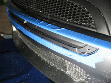

Here's my install
Mine took a little longer since this was my first foray in the mod world
I took it slow and easy. And the best advice I can give is get a buddy
to help. Mine happened (Mr. Precision) to have restored a couple of cars.
This post is long I just wanted to share all my steps and thoughts.
What is also very helpful having a hand is some to hold the grill while
it’s being cut. Unless you have a vise mounted to a work bench.
ALSO NOTE: I opted not to paint behind the lower grill.
You see through the upper grill and the bottom grill so I wanted
the look to be consistent. I felt that area would appear to be too
dense compared to the other two grills. And Illinois law requires
a front plate so the middle is covered anyway. Even without
the plate I wouldn’t paint behind the grill.
First I could see any reason to remove the bumper cover.
The extra work of jacking up the car, removing the wheels and then
removing the bumper cover. Not necessary.
With the advice from belikeanthony post, the lower grill pretty much
just popped off. Use a thin but strong flat head screwdriver.
Wrap the edges in tape and then wedge it into one end of the stock grill
And slowly pry up. Once you get a few fingers under there you can
Work your way down the length of the grill and pop it out.
(Be careful when you wedge in the screwdriver, even though you have
tape around the end and shaft you can still leave impressions in the
bumper cover.)
The double stick tape was a little of a pain. It was pretty cold in Chicago
the day I did it so one side of the tape came off without much hassle.
The other side wouldn’t come up at all. So I use gas and a flexible spackle knife.
(don’t worry about gas on the paint it won’t hurt it, I know this
from Mr. Precision) Get a pair of rubber gloves for handling chemicals
or strippers etc. if you don’t want the gas on your hands.
You’ll need about a quarter cup of gas. Cut a piece of old towel about 2” sq
for applying the gas. Apply a generous amount of gas and work off the tape with
the spackle knife. Keep working back and forth until done. The gas brakes down
the tape and it’s great for getting off the residue.
CUTTING THE AREO GRILL:
We went really slow on this. Mr. Precision, measure 5 times cut once but
not a full cut, measure again then complete the cut. Measure again the smooth
out your work. The saw/grinding Dremmel disc rocks. We went through 2 discs
for this. The plastic of the grill wears the cutting disc pretty fast.
As stated by belikeanthony use a white color pencil or a china marker to make
guide marks. Once you get the depth on your cuts go in with the Demmel disc
really light and smooth the edges. YOU WILL TAKE OFF A LOT OF MATERIAL
FROM THE AREO GRILL. DON’T BE ALARMED. YOU SHOULD HAVE APROX
1/8 of PLASTIC LEFT AFTER THE CUTS. AND DON’T CUT OFF THE TABS.
CUTTING THE SLOTS ON THE BUMPER COVER:
First we used painters tape and masked off the perimeter of the area.
Two reasons, it gives you a place to mark your cuts and also protects
the bumper cover if you slip with the drill. Again I just followed earlier
post, first drilled small holes one right after another for the length of the
slot then went in with a larger bit and drilled out the space between the
smaller holes. Then we used the 1/8th bit to clean it up. (Use the drill bit
like a saw, move in and also slide left or right)
CAUTION: When drilling the slot holes on the lower lip go slow use
easy pressure and angle the bit up so you don’t risk catching the edge.
It’s very shallow step to the lower edge.
Then pop the new grill in.
Sorry for typos and any bad grammar. I hopes this helps anyone.
I have more picts. But I'm not sure how to post.
