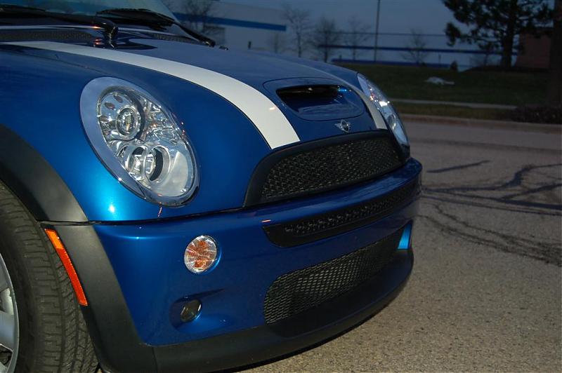

edit Here are a few pictures.
I actually didn't take any good pics after the install. I was just thrilled with the look and had not gotten out there yet with a good camera. I actually had a small digital with me at lunch today after running some family errands but didn't manage to find a moment to snap a couple of pics. I tried in the garage but the magic is lost on the small camera. I will see if I can snap a couple tomorrow morning. I guess thats my old lurker habits coming out more than anything else...

From: chicago burbs
more pics
And just a few more.
