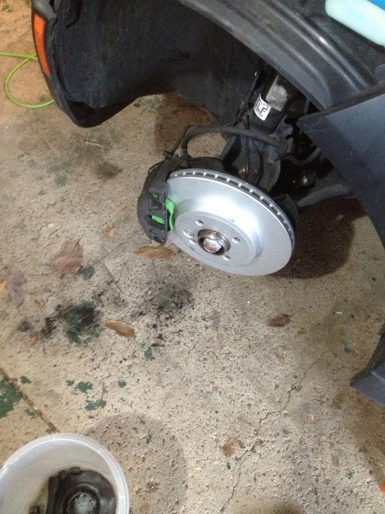

Ok my job is done
My experience was hindered by a frozen torx screw in the passengers side rotor. Breaker bar was no use. It stripped quickly. Yes I used penetrating oil and a lot of it. tried to drill it out and broke a few bits and a new extractor.
My solution was simple. Local pepboys are my pals had my new screws so I put everything back together and they put it on the lift. torched it until red hot and BAM IMACT HAMMAR!
put the new one in. drove home and finished the job. went with WMW rotors and greenstuff pads (thanks way). work great no light and we are back on the road.
Don't fear doing the rotors be careful and if you do not have an impact hammer or torch you a plan B (only added 50 bucks to the job FYI)
If you are changing rotors I would highly recommend you break these first! If things go bad you can get the thing out at a shop. best 50 bucks I spent today.
driver side note my caliper balancing box
new rotor on pads going in
and there you go
I know a little fuzzy but you can see how bad the old pads were ( so much dust)
