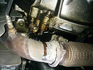

it appears my wife's 08MCS has the same issue (and a leaky oil pan that apparently wasn't fixed right when the timing chain/TCT was replaced under recall...)
Oil cooler/filter housing gasket replacement-ex9guum.jpg
is there anything else this could be before i start ordering the parts listed on the first page? i know they have already replaced the oil lines for the turbo while it was under warranty so i'm not sure i need to do those as well.
any advice would be appreciated! thanks for the writeup, mbwicz.

From that corner and location its most likely the oil cooler gaskets. Wipe up the oil as best you can and see if the pan has a leak. The older MINIs have the paper gasket, ones that had it done by MINI Used a sealant per a TIS.
https://www.northamericanmotoring.co...leak-pics.html
and oil pan gasket:
https://www.northamericanmotoring.co...e-cause-2.html

On my car, the downpipe had never been removed before. I bought a new exhaust clamp (where the downpipe connects to the rest of the exhaust), and just cut the old one off. I also replaced the drain line from the turbo. This has to be removed anyway, and mine had some crusty crap in it. There is no pressure in the drain line, so I doubt that it would be leaking.
I also pulled my oil pan and used RTV to seal it, it hasn't leaked.
I hate to keep bringing stuff up, but if you go through the trouble of getting the heat shields and downpipe off, you want to fix every $20 potential leak that you can. Also, don't forget a good light so that you can see that all of the surfaces are clean before reassembly.

This looks almost identical to what my oil leak looked like to. I was convinced it was the oil pan. Took it to a shop to get a final diagnosis and they said it was the oil filter housing gaskets. Getting that and the water pump done on Sunday.

Yea, mine was in the same location, wiped it and found it was the filter seals. Did it all at once.
