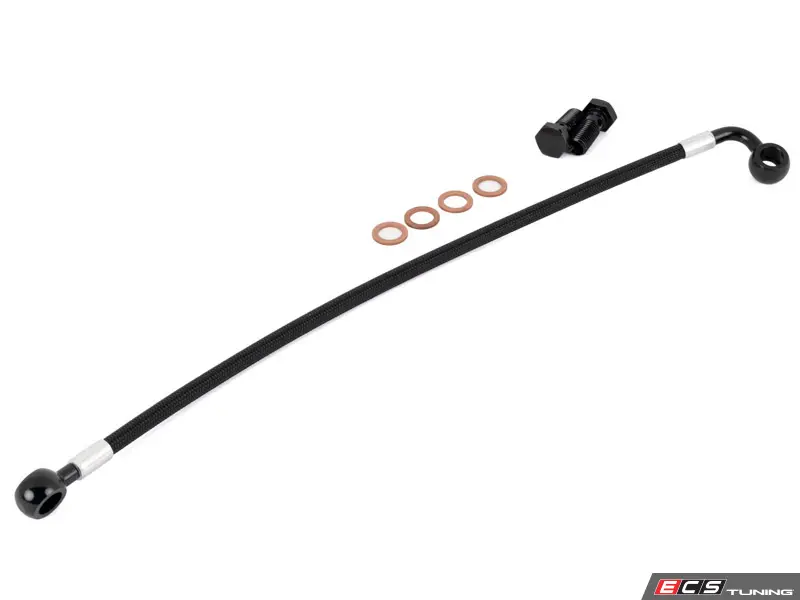

Scratching my head on this one. Reading through this thread, but have not seen anything that calls out what the issue I might have.
I recently replaced the turbos feed and return oil lines. Also replaced the the oil filter housing gaskets while I was in there. After putting everything back together. Toped off the oil, and filled and bled the coolant system. Now I have a rough idle issue. seems that there might be a vacuum leak? When pulling the oil cap off while the car is running. There is some suction that pull the cap back on.
Before going to pull the heat shields back out and the down pipe. Looking to see if anyone might have some thoughts.
2011 Countryman S

Was finally able determine the issue of the rough idle. After running a few test and reseting the vanos system. Turns out the cam timing is off. Best I can figure. Is that at some point the oil pressure was too low and released enough pressure off the chain guides. Which allowed the chain to slip a few teeth. So next I will be getting the timing chain and cam chain tensioner replaced.

Another question for you - I saw that there is a Turbo Oil Feed kit from MAMBA-TEK.
Is it better than the original? Does anyone have experience with it?
(I had my Turbo Oil Return Pipe 11658617069 replaced at my company about three years ago - do I need to replace it again? Or is it recommended to replace only the Turbo Oil Pipe Line (the hard pipe) 11657534454?
In terms of water/oil - so if I understand correctly:
1. Disassemble everything including the auxiliary water pump? (Do I need to drain all the coolant and fill with new coolant)?
2. Disassemble the oil cooler and replace all the seals and put it back.
3. Close everything, add coolant and then drain and change the engine oil and start the engine?
Is this the correct order of things?
Apologies for all the questions, I'm worried about the combination of oil and water and the order of operations.
Thanks a lot in advance

Likes: 197
So you think what you just fixed is leaking?
How many miles on that half baked POS?
Did you change the gasket on the vacuum pump?
Yes replace the oil return if you're gonna take everything off again. I used Detroit Tune oil feed line.
Put the car in repair mode so you have room to access the bolts.
Yes your order of operations is correct. You need to drain the coolant and oil because you will cross contaminate both when you take the oil cooler off. The auxiliary water pump just needs to be disconnected.
