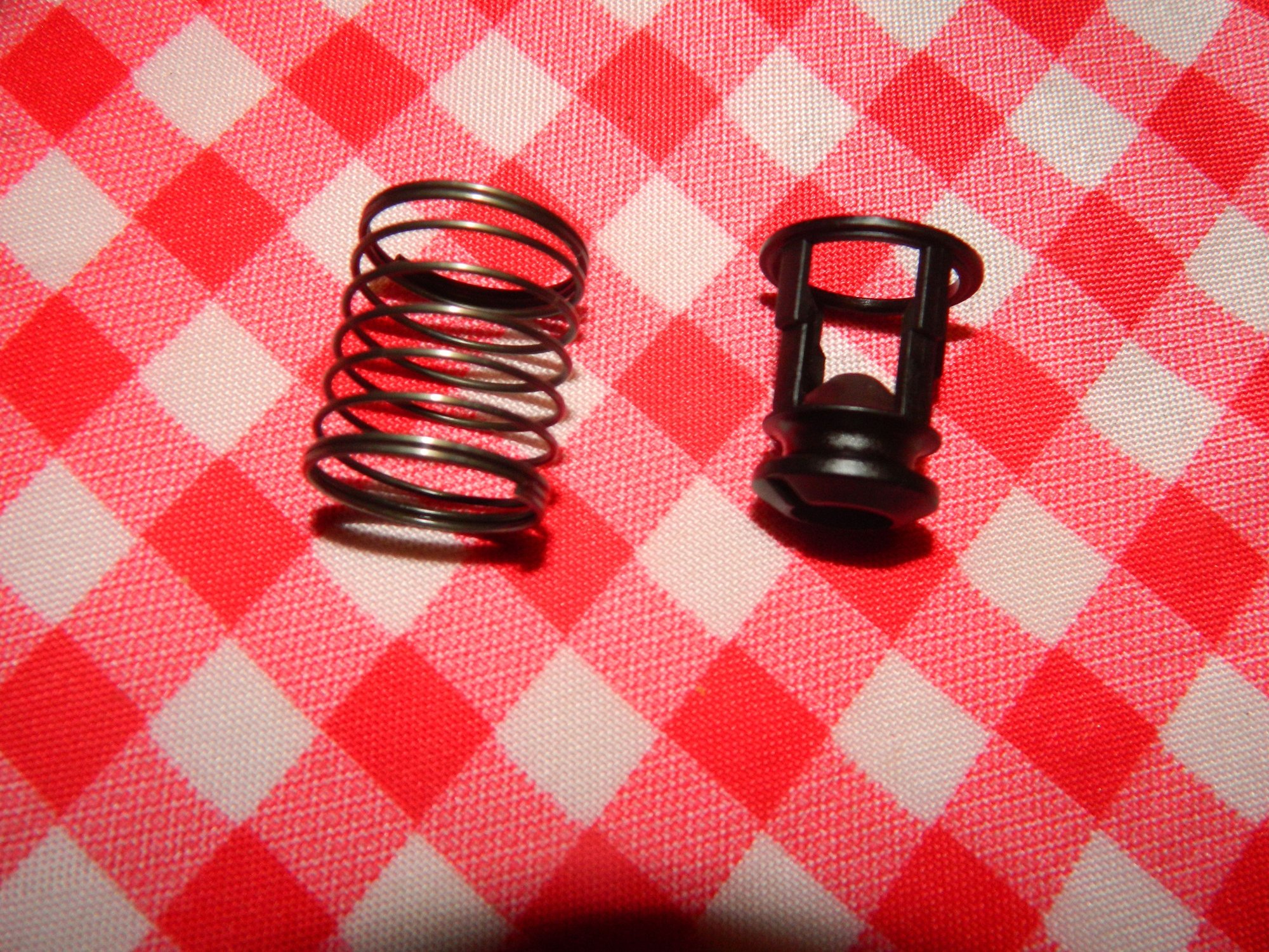

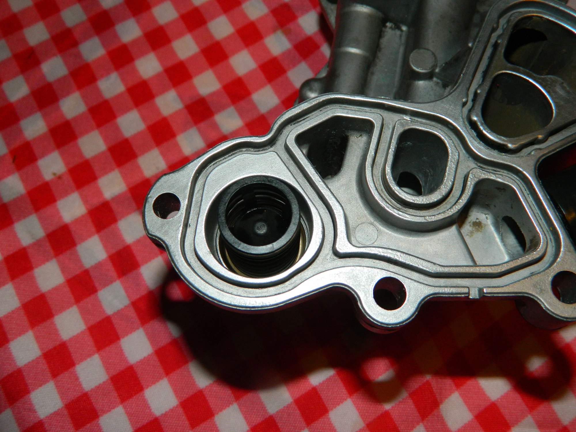

I am in the middle of doing this pita job on our 2007 R56 Cooper S N14 and waiting for the gaskets to arrive.
This morning I noticed a small spring and plastic part in my oil drain waste pan which I believe is some kind of restrictor that sits in the bottom of the oil cooler housing.(pic2)
Can anyone advise if this is still complete as I only found the two parts.(pic3)
In various pictures I have seen this part seems to sit flush to the surface.
Although I can easily reassemble the two parts it now sits above the housing so I am thinking I may have lost part of it-perhaps something that retains it? I hope not!
Thanks in advance for any replies!
R56 Housing
Shows restrictor?
Should there be more than two parts?

Here is some info on the housing, 11428643749
https://www.ecstuning.com/Search/SiteSearch/11428643749/
Thats everything that comes in the filter housing with the gaskets.
Here is the diagram of the breakdown. The filter tube restrictor and the spring are part of the main housing.
https://www.realoem.com/bmw/enUS/sho...30#11428643749

Thanks for your reply the help is appreciated!
The spring looks to be under slight tension so I suspect it is held in position at the base with maybe an O ring ....see pic below...can you confirm?
There is an ident at the base of the black tube......suggests something should go around it.
See pic below

Yes, i dont have one in hand right now to look at and when i did my gaskest that unit did not move or come out. Check up the line or in the black for a missing gasket or something that went on that end. That unit came out or fell out when you disconnect it from the block?

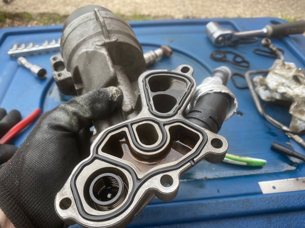

Did mine this weekend, thanks for pics everyone. I replaced oil feed and return lines as well as the oil filter housing gaskets. Used various youtube videos too.
The return line is fully square to the turbo see pic - initially I had a gap and I didn’t know whether it was meant to be flush or not and couldn’t find any pics (I had already removed the original and hadn’t noticed). It is flush when seated correctly.
Oil line route
New gaskets
Make sure top of turbo oil return line is fully home. Mine took a bit of work to get fully seated.
