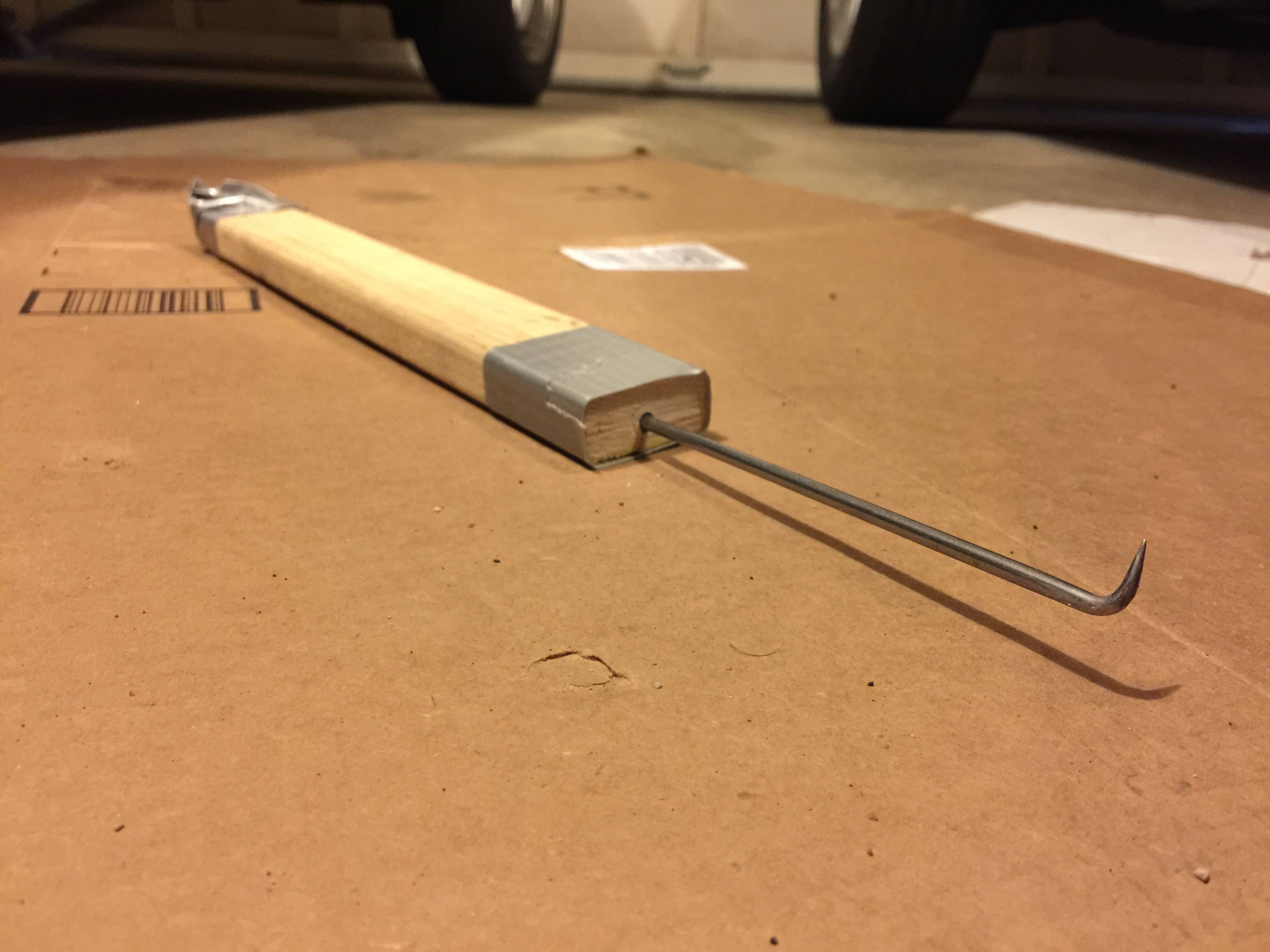

This post is a few weeks late but I ultimately got the broken piece out of the water pump by using an extended pic. I needed a second person to move the pic around from the driver side of the engine while I laid under the car with a telescoping mirror and light. What a PITA! When trying to install the new water pipe it seemed like no matter what I did I couldn't get it all the way inside the water pump - the gasket was still outside the port. After tightening down the thermostat housing I checked again with the mirror under the car and could tell that the water pipe was now fully inside the water pump port. The car has been running great without a leak for the last few weeks. Thanks for the help.
