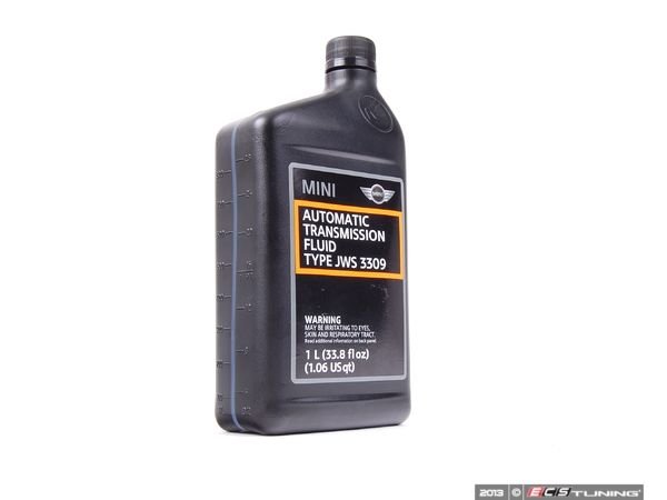

For automatic R52 S R53 S Auto.
Yep, those are here,
https://www.ecstuning.com/Mini-2005-...Transmission/2
24117570791
https://www.ecstuning.com/Search/Sit...h/24117570791/
24117570792
https://www.ecstuning.com/Search/Sit...h/24117570792/
I would replace the gasket ring , but since the plug is not a heavy used plugs, maybe a couple times in the lifetime. You should not have to replace it unless it damaged or for prevention.
All other fluids, filters, and kit here For automatic R52 S/ R53 auto
https://www.ecstuning.com/Mini-2005-..._Transmission/
