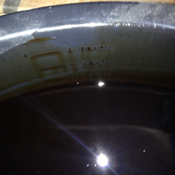

I had checked my oil a couple of weeks ago, first time since the last dealer oil change, and had to try multiple times to get some kind of a legible reading. After leaving the cleaned dipstick out for over an hour on 3 different occasions, I could finally see there was some textured area showing in the middle of the measurement area meaning I must be within a quart of maximum fill.
I've now decided to do my midpoint (5000) miles oil change without replacing the filter. I may eventually start doing oil and filter every 5000.
I drained the oil as completely as possible on level ground and collected approximately 4.25 quarts.
Is this about how much should come out without a filter change? I have an N16 engine (2013 "Justa ")

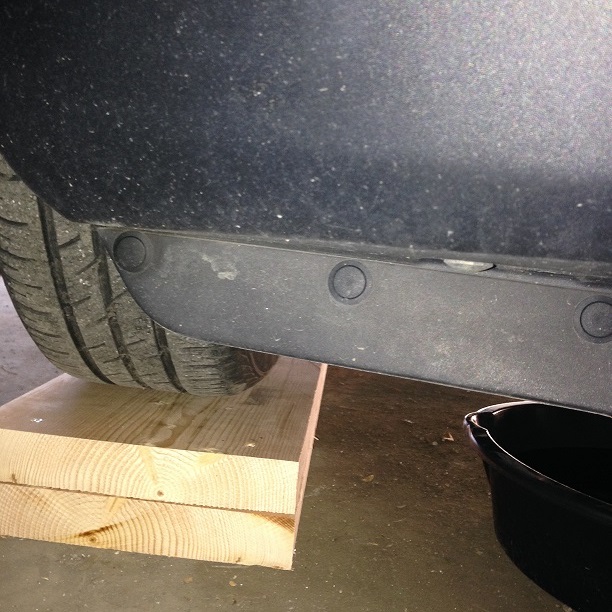

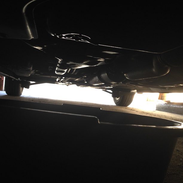

I finally got around doing this on my 2009 Clubman.
I swung by my local hardware store and had them cut a 10ft 2x10 into 4 pieces (2 pieces 3 feet and 2 pieces 2 feet). I then used 4 #6x2 wood screws to screw the 24 in pieces on top of the 36 inch pieces to create 2 ramps. Unfortunately, they wouldn't do angle cuts, or I would have asked them to cut the ends at a 30 degree angle. The reason I didn't use a jack is my garage is too narrow. Total Cost~$10
Driving up on the ramps, it gave me enough clearance to fit my 3/8 ratchet and 8mm hex bit socket. I bought the 8mm hex bit socket at Menards for $1.97 (Crescent brand). The only issue is I didn't have enough clearance for my oil pan and wrench without creating a mess, so I used the cheap one that comes in the $5 oil change kit from Advanced Auto (includes oil pan, shop towels, orange hand cleaner and a funnel). I ended up using all 4 so it was well worth it and transferred my old oil to my other oil pan for easier transporting for recycling later.
The hardest part for me was taking the oil filter housing off and waiting all day for the mailman to deliver the oil filter. I used a 27mm 6 point socket, but I think the dealer might have overtightened it. After some extra muscle, I was able to get it off. If I had tried taking it off with a 12 point socket, I am pretty sure I might have rounded off the plastic, due to how tight it was on there.
After I changed the drain plug crush washer and tightened to 22 lbs, I re-installed the oil filter gasket with the OEM filter I bought on eBay from Prestige Mini ($12.60 + free shipping) and then started by hand tightening and finished if off with my ratchet. I then refilled using the 5 liter of Lubri Moly 5w30 from Bavarian Auto ($43.90), and used about 4 liters.
Finally, I checked the oil level, started the car and and then rechecked for oil leaks. After cleaning up I reset the oil change interval indicator. I think this was one of the easiest jobs and believe any person with the right tools can do it, even a noob.
