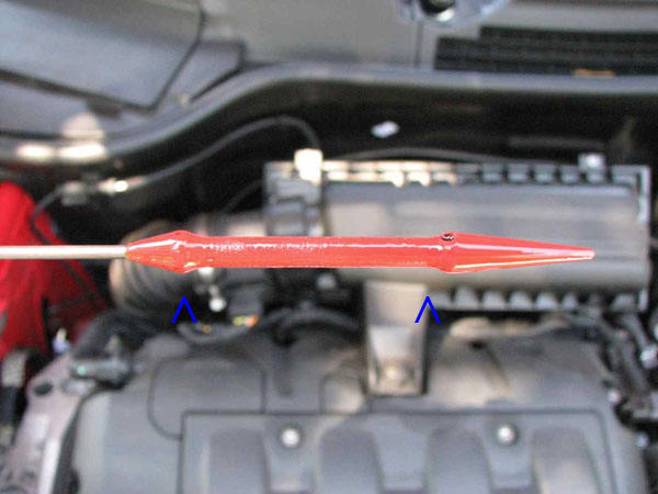

so is the bottom part of the stick (point) the indicator for low and the bump at the very top near the metal considered full?
I my level looks like its at the top bump.

The blue marks indicate the upper and lower limits. They are at the base of each cone, not the tip.

Thanks rduke222^^^^^yes exactly my thought. So im closer to the max mark. Which is cool cuz I think with the oil at the middle you woud get the cold start chatter alot are complaining about.
