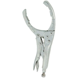

After pulling the housing out of the tank I used several methods to try and get the lid off, it was really stuck. I ended up using oil filter vice grips and a large flat bladed screw driver in the housing just below the fuel hose.(See upper left side of picture, screwdriver goes below fuel hose inlet)
The oil filter vice grips worked perfectly to grasp the housing and the large flat blade screw driver fit in the large cavity just below the fuel hose inlet(do not use the hose inlet hole to pry!) to allow the 1/4 turn and off came the top. If I would of known this before hand the job would of been an hour or so job. Pop the metal ring, lift up hosing just enough to grab with the vice grips(not much grip pressure needed) then twist off the top. Replace the filter and o-rings, put the top back on, work the new seal over the housing and down into the tank so the upper lip is flush and put the retaining ring back on.
I would highly recommend having the vice grips handy, no telling if your housing lid is going to be easy or hard. Mine was really stuck and this did the trick and would of worked easily in the car. Once locked down the vice grips would also hold the housing out of the tank while you work on it. As for the filter my car had 100k on the clock and was a black mess. I swear my car seems to run just a bit smoother after the filter change and my high pressure fuel pump(2nd gen MCS) was replaced just before I bought the car a few months back so I wonder if the clogged filter had a detrimental effect on on the pump.

$48 for the filter kit, $8 for a cheap HarborFreight filter-plier to get a good grip on the canister, and $1 for a one-time-use turkey-baster to vacuum the crap out.
