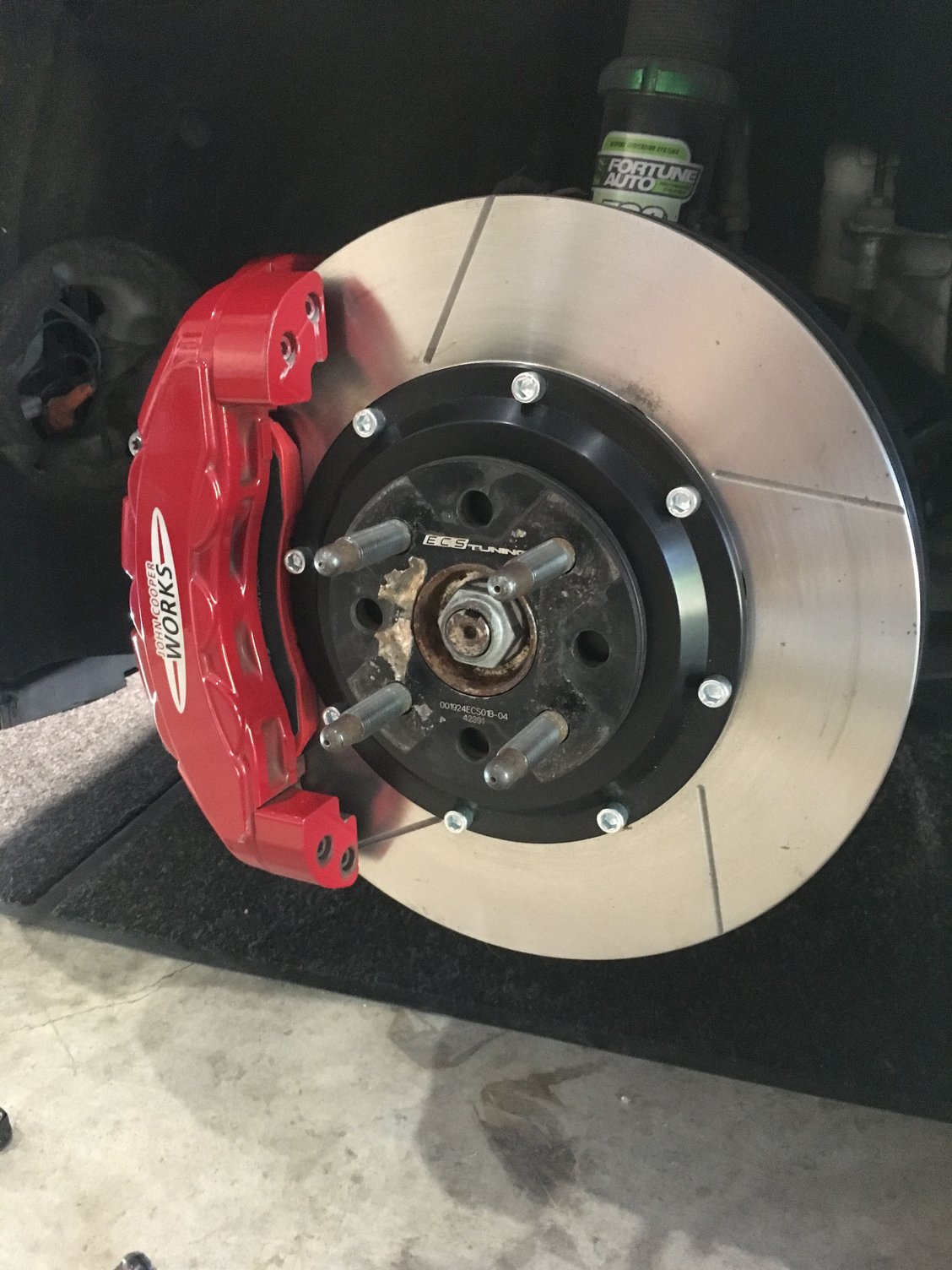

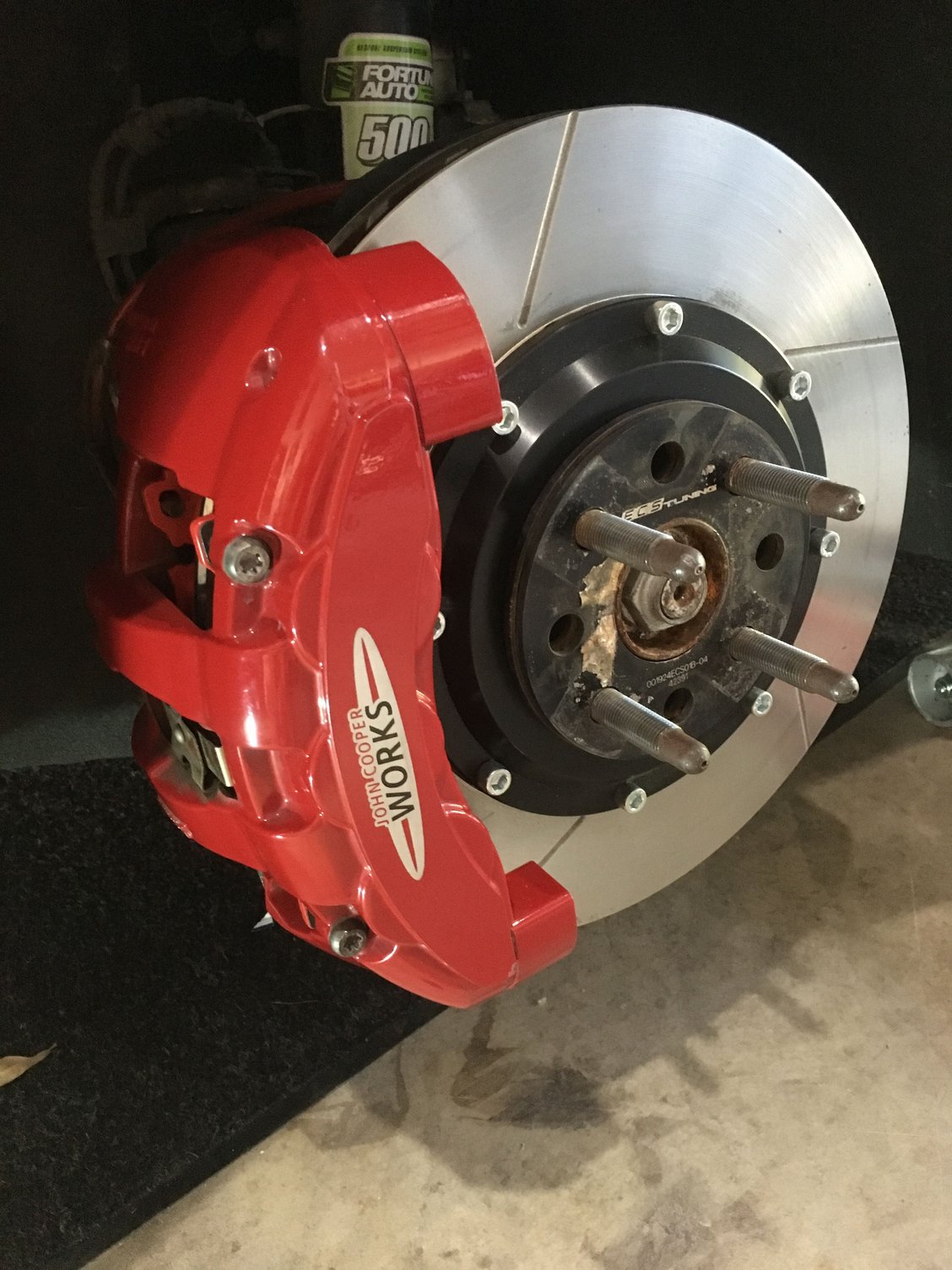

Old Dec 8, 2022 | 07:26 AM
Posts: 36,744
Likes: 2,541
EBC reds I have used. Hawk HPS/Plus also. The brembo stock pads are good but dusty. I done track days with the GP2 BBK upgrade on my R58 JCW and the fade was not that bad. But if you push it you can feel a little bit of it over time.
Some people when they track tend to ride the brakes and cook the seals on the GP2 pistons. Nice thing is the MINI on long tracks, you dont need the ride the brakes as the stopping is there.
Yep shares the same as the 135i w/ factory BBKs
