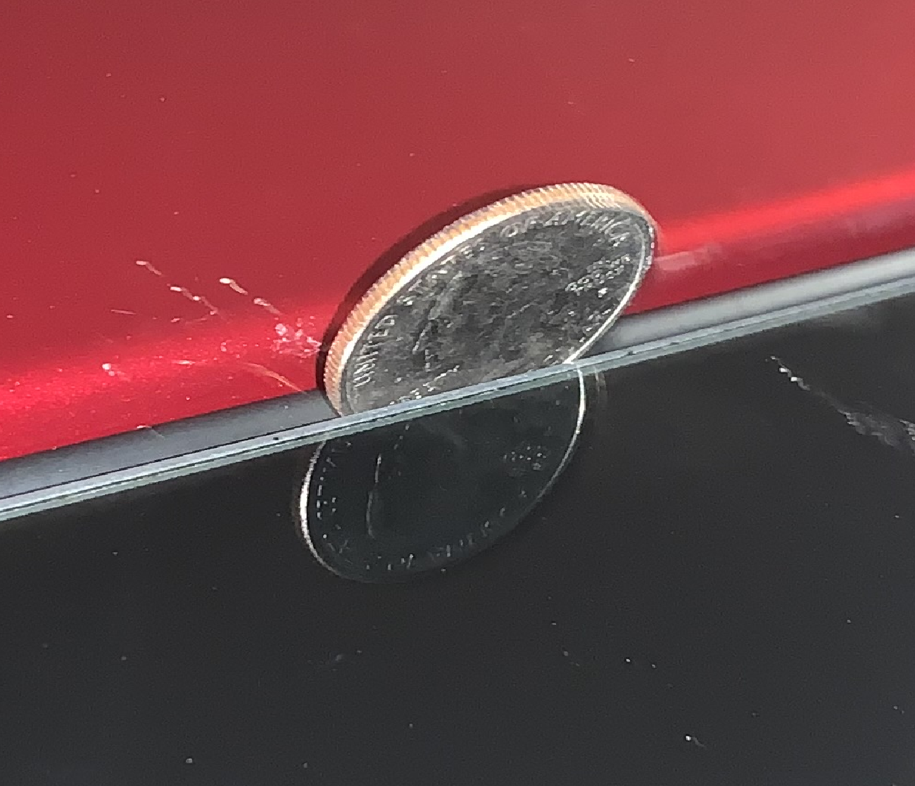

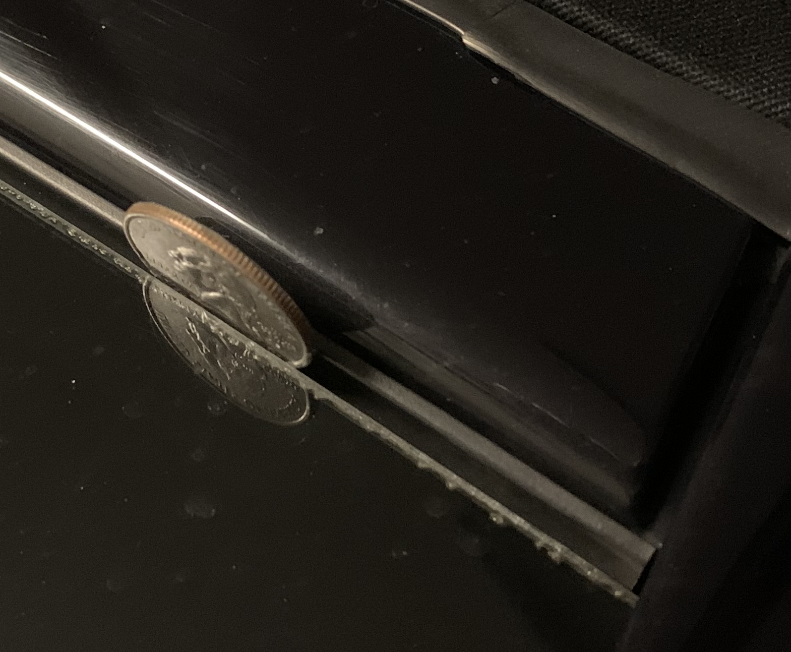

a gap around the windshield is common with today's mounting methods .... here's my 15 R59 ... I put coin in the standard gap around the windscreen ... this allows for expansion due to temp ...
Not unique to MINI ... here's the same thing on a 19 Mazda
the whistle comes from a gap in the sealant UNDER this edge .... it happens ... it's a booboo ..... question is how does your installing company DEAL with it . . .
