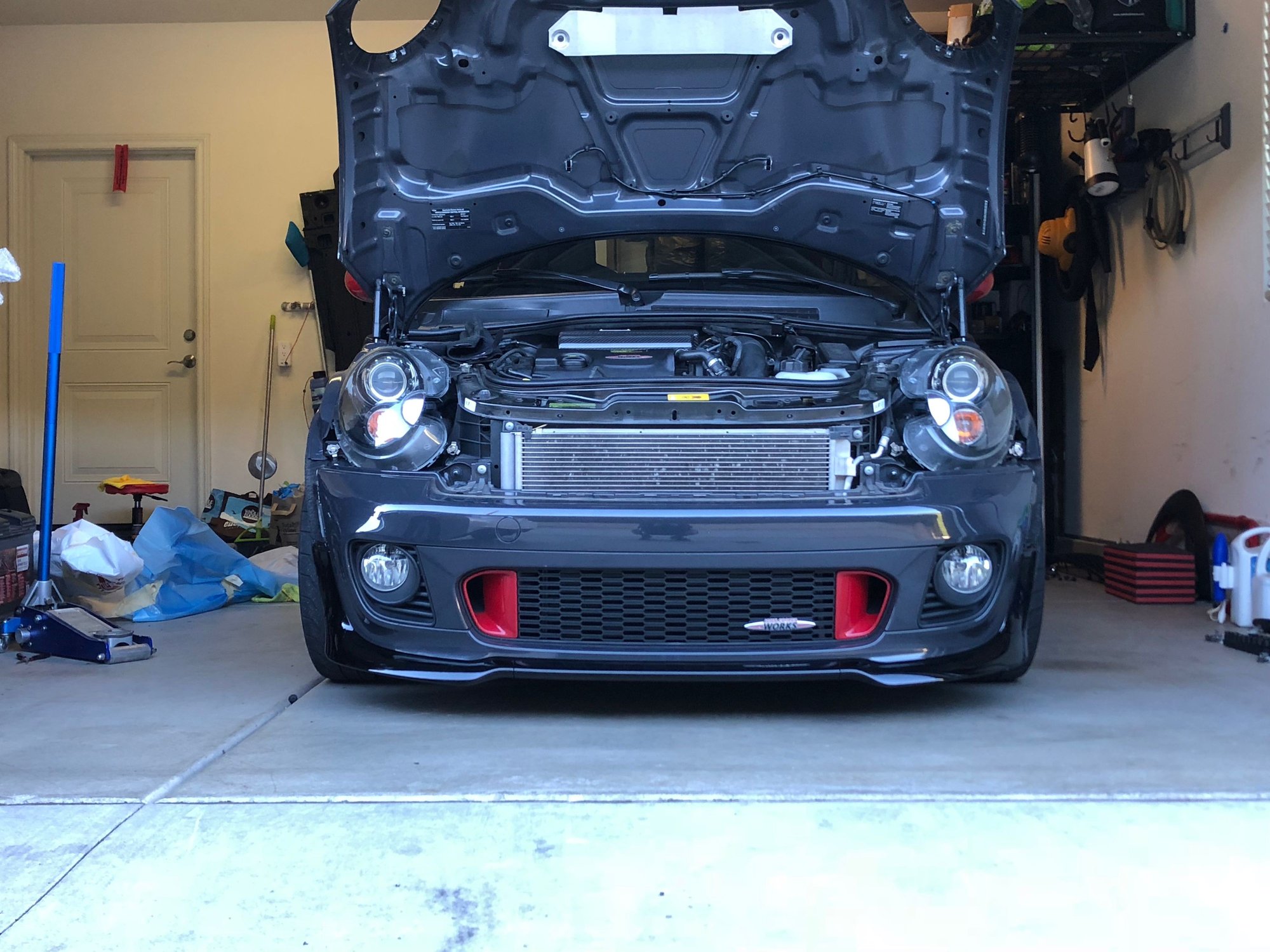

Well, I won't be posting as much as I used to. I really don't have much drama in the build process since I've been down this path several times now, so this build is essentially, a recreation of my final build from my old '10 Camden S.
So far:
ECS Tuning Kohlefaser Luft-Technik CAI
Wagner Competition Intercooler
M7 J-Brace
iPE Innotech Valvetronic Exhaust
AR Design 3" Catted DP
SPC Rear upper and lower control arms
CAE Ultrashifter
17x7.5 TE37v in Bronze
Bridgestone RE-71R 215/45/17
On order:
Stoptech Trophy
Ohlins R&T with Vorshlag Camber Plates
Why the Stoptechs? Lose the weight of the 6pot brakes, smaller, forged, rebuild is easier/cheaper than what BMW can offer. Plus, the offsets on my new TE37v are aggressive, so the 6pots require me to run 15mm spacers, which are ridiculous and I wouldn't be able to run them. So getting the Trophy brakes with the Ohlins will help clear with probably a 10mm spacer and about -2 camber.
The GP has been pretty sweet compared to my old Camden, outta the box, but I do more riding on my bike these days than driving the GP so the mileage will continue to stay pretty conservative.
Cheers.
