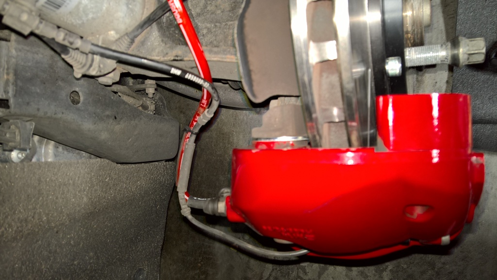

Installed the rotors yesterday. (And pads, lines, and pistons. But this will only be about the front rotors.)
Todd created this set based on the OE rotor blueprints from brembo. All those measurements were in metric. But his machine shop only worked with imperial. So the dimensions are not quite exactly the same.
There is no grub/set screw hole. It will be easier to hold it in place if you have studs (which I will be getting later on.)
Now the important bit: The rotor with the hat and hardware weighs in at 15.2lbs. The stock used rotor weighed about 19.8 lbs. I would guess 20-ish lbs brand new. So weight savings are about 5lbs per corner.
I lined up the caliper and test fitted it onto the rotor. The pad was too close to the hat. Note: I am using Hawk DTC-30 pads. Fitment may be different for other pads.

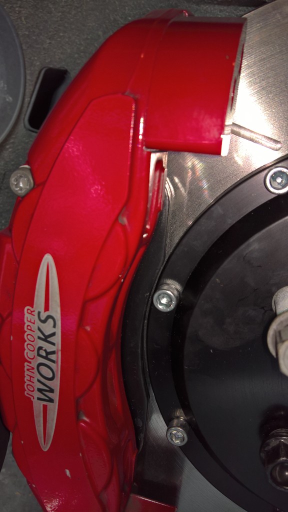

So as Todd predicted, I needed to add a spacer/shim to where the caliper mounted on to the bracket.
And voila! Perfect!

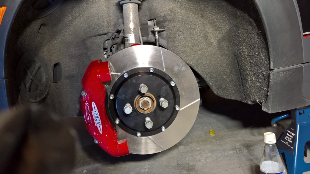

This is how it looks:
I dont have any real impressions. Track season hasnt kicked off yet. Ill have to see how it deals with the heat.
The steering does feel a wee bit lighter though.
