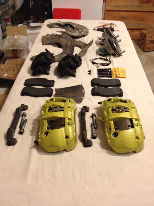

I understand that the 6 piston OEM Brembo front calipers on a stock GP2 are the same as the ones that came stock on a BMW 135 ( the grey ones )
So am I to be correct in thinking that the BMW performance BBK. that was offered for BMW 128's ( the yellow ones ) would fit a GP2 ? I'm guessing I would need that caliper brackets or are they the same also ? What is the rotor diameter of the GP2 OEM rotor?
For clarification the pics below are the set of calipers in question. I removed theses off my 128 before turning her back in. . I planned on selling them but maybe not ? I have a fR58 JCW so it may be a cool upgrade if I feel the OEM JCW calipers can't hold up to next years 10 track days.
I wonder if the backing plates are the same ?
Thanks in advance for any input.

Visually, they do look very similar (if not identical), however, you'd need to source the brackets to mount the caliper to the front hub. I doubt the brackets you have from the 128 fitment will work on the R58.
The calipers are the same. Pads are the same.
The hubs are different, the minis are 4 bolt pattern and 1 series are 5 bolt pattern. The rotors are different sizes as well.
If you were going to use these the easiest way would be to buy oem GP2 rotors.

Thanks guys.
Duh. I didn't even think about the spindles/hubs. Of course they are different.
Ok so caliper brackets , rotors, and backing plates it is to convert shouldn't be any problem to source those as they are all OEM.

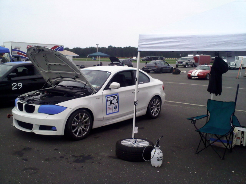

The 128 in question. She was fun to track. The heated seats were great early and late in the season

IF the calipers are actually the same between the 135 and the GP2 then you need caliper brackets, rotors, backing plates, and maybe brake lines from a GP2. They "should" bolt right up. I don't see the bracket as a separate part # from the caliper though so that may cause you some problems.

In fact if you look at ECS Tuning's website you can see the part numbers clearly on the brackets.
http://www.ecstuning.com/ES2643016/
Scroll through the images.
Brembo caliper bracket part # 20.9747.85
Seals for the pistons part # 20.4872.40
