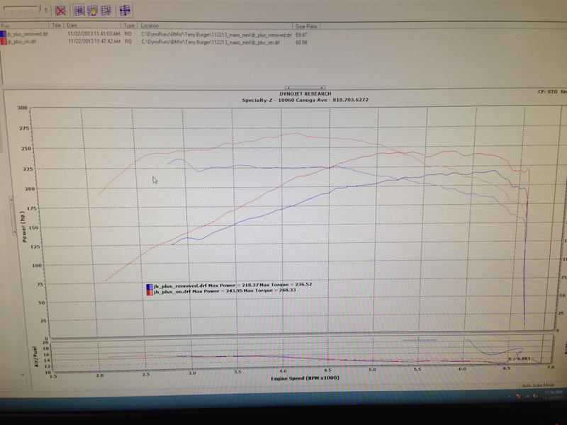

I'm that guy!! Now with my second cat removed I'm pretty sure 250whp and 270wtq is were I'm at I want to change the plugs to one colder, but not having luck. Factory plugs are from France and I can't seem to cross reference them. Originally Posted by ChiliRedR56raleigh

I'm that guy!! Now with my second cat removed I'm pretty sure 250whp and 270wtq is were I'm at I want to change the plugs to one colder, but not having luck. Factory plugs are from France and I can't seem to cross reference them. My little GP is a beast. Need stickier tires Mario Sent from my iPhone Office

Sorry, let me clarify. The JB+ makes almost as much power as Stage 1 NM ECU tune which is what this thread is about. (20hp/30tq for JB+, 25-30hp/30-35tq NM). On a bone stock car the JB+ is indeed pretty close.Originally Posted by scubbysnacks
