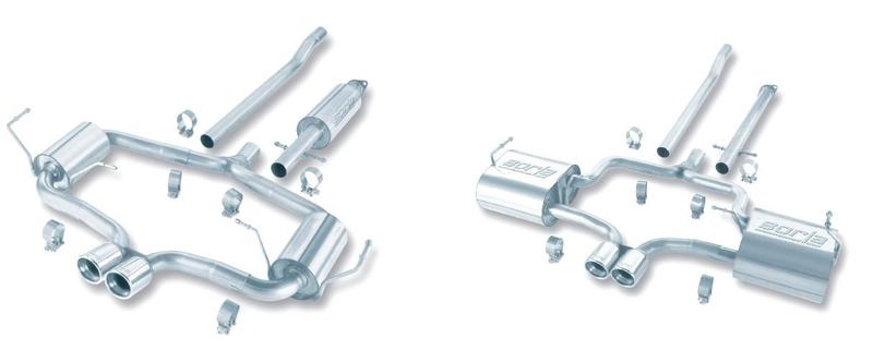

I came from a 2003 R53 with Borla Sport cat-back which I really liked but it did drone at certain engine loads so when I got the 2006 R53 GP I wanted a louder exhaust than the stock JCW exhaust. I tried three setups before settling on the Milltek (same as Stratmosphere).
1. Removed resonator from JCW. A little too much snap, crackle, pop.
2. Borla Sport. A little too loud and too much drone in the no rear seat or insulation GP.
3. Milltek with resonator. Just about right. Louder than JCW with nice sound. No drone. I wish it was slightly louder but I suspect that will begin on drone.

As I am lucky enough to not have to commute in this car I am going to go with the Borla sport - that way if it is too obnoxious I can always work on adding a front resonator.
I liked the look and reputation of both the Milltek, and Stratmosphere but found lots of posts stating it was fairly close to stock and would really like a little rasp, especially low down.

So after 100 miles with the Borla it is coming off. Should have gone with my gut and not been talked out of the Stratmosphere by a helpful store..... Sound truly is subjective....
The Borla is a great exhaust, nice build and weld quality and sounds great. As suggested though just a little too 'droney' for a GP.
I will be putting the JCW back on and thinking hard about what to do next. Unfortunately having just moved from Denver to Little Rock I do not believe I have an active Mini community to work with to sit and sound test with...
The good news is that for anyone looking for a little louder sound, or with rear sound deadening, I have a very lightly used Borla for sale.... Even comes with an unworn Borla cap!

Removed the Borla and replaced with a Stratmosphere, non resonated system from WMW.
Initial impressions:
Sounds great - nice tone and quietly extenuates the burble. Definitely gives you more 'feedback' noise at all rev levels and throttle positions and the burble is really (really) nice.
Overall an octave or so higher pitch than the Borla which is also what I wanted - sounds like a MINI should, not a V8.
Very little drone, It didn't bother me at all although I was a little self conscious of it when my wife was in the car. She said it didn't bother her though so apparently not an issue.
All in all from a noise standpoint it exactly what I was looking for.
Bend and build quality is OK. Some of the welds are not great - especially those on the inner hanger assemblies. I also feel the design of this hanger assembly could be better as a slotted, rather than hard welded design of these two plates (you'll understand if you see) would have given much needed adjustment.
Initial set up had enormous tension in the system, the tips 3/4" of an inch to far forward to me (i.e not visible from above) and heavy contact with the top of the valence. The system was also off center by 1/2". The tip forward issue did not appear to be because of too deep slip fit insertion as this was minimal)
Although some of this I am sure is car to car tolerance stack up this particular system definitely did not bolt on and line up like the Borla.
We did manage to bend the hangers a little to stop the valence melting but still not aligned right.
This weekend I aim to 'tweak' the exhaust hanger rods and shim under the center car hanger to get the much needed 1/2" down and 1/4" to the right...
